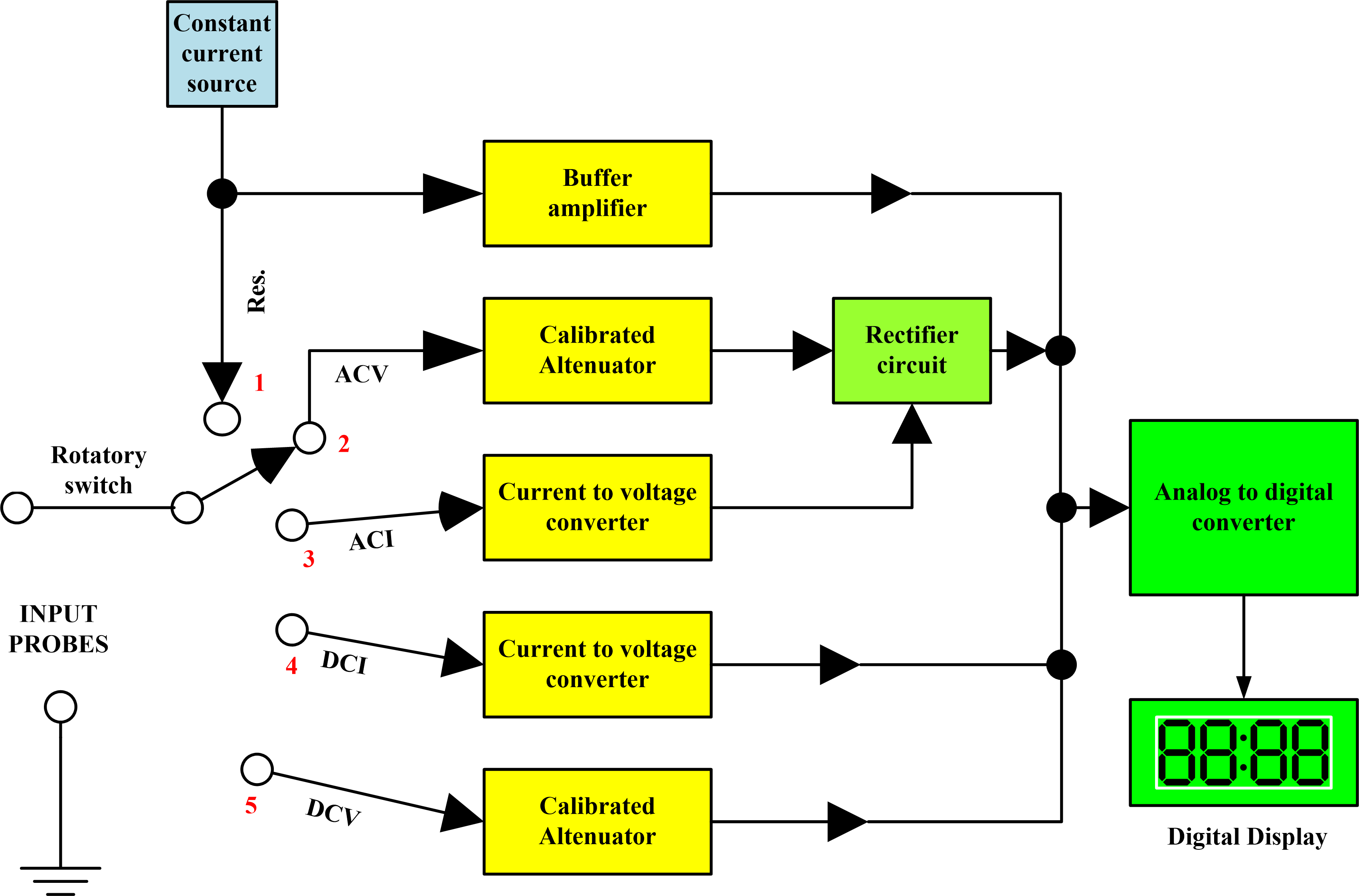

There seems to be a contradiction between what various PF members have told me about digital multimeters. On post #21 of my thread "How does a digital ammeters work?", PF member daven responded to me. I will put what davenn wrote in green text. Davenn wrote the following: I should have really added this in the previous post, just to make it really clear
ALL meters …. current, voltage, resistance, analog or digital, measure a voltage which is then directly displayed or digitised then displayed"
In post #27 of the "How does a digital ammeter work? thread, berkeman also responded. I will put what berkeman wrote in orange text: "It's a simple issue. Yes, DMMs use ADCs to convert the voltages into digital numbers. There are a number of different ADC types, and possibly all are used in different versions of DMMs. You can read more about them at Wikipedia, using these search terms"
Berkeman said that DMMs use ADCs to convert the VOLTAGES into digital numbers. Berkeman did not say anything about how DMMs measure current.
However, in my thread "Ohm reading when there is a short in the condenser motor", I asked jim hardy the following question: "When one lead of a multimeter is attached to a circuit and the other lead of the multimeter goes to ground, is it the case that a multimeter measures conductance in a circuit by applying voltage from its internal battery to a circuit and then the multimeter measures the current flow that leaves the multimeter?"Jim hardy told me that the answer to my question is yes. But I think that maybe jim hardy just meant that when one lead of a multimeter is attached to a circuit and the other lead of the multimeter goes to ground, a multimeter measures conductance in a circuit by applying voltage to its internal battery to a circuit and then the multimeter measures SOMETHING (perhaps voltage) that is used to calculate conductance.
When one lead of a multimeter is attached to a circuit and the other lead of the multimeter goes to ground, does the multimeter measure conductance in a circuit by applying voltage from its internal battery to a circuit and then the multimeter measure the current flow that leaves the multimeter? If so, how does the multimeter measure the current flow that leaves the multimeter? Does the multimeter measure the current flow by charging a capacitor and discharge the capacitor and counting how long it takes (Dual Slope ADC)? How does it work exactly?I have a Fluke 116 multimeter. When my Fluke 116 multimeter is set to read resistance, and when my multimeter measures conductance by applying voltage from its internal battery to a circuit, how does my Fluke 116 multimeter measure the current flow that leaves the multimeter? Does a Fluke 116 multimeter measure conductance by Successive Approximation ADC, Flash ADC, or Dual Slope ADC?
Conductance and resistance are measured in much the same way. A constant current (see block diagram) is sent through the component under test. This causes a voltage drop across the component which is scaled (by the buffer amplifier) and sent to the ADC.

I can't find a block or circuit diagram for the Fluke 116 so I can't be sure if it measures resistance by..
a) applying a fixed voltage and measuring the current, or by
b) applying a fixed current and measuring the voltage.
I suspect its b) but can't be certain. Jim suggests its a) he might be right
I don't think the Fluke 116 can display conductance. The spec I found suggests it just display resistance.
I don't believe connecting one probe to ground and one to the circuit is significant to your question. A DMM will try to measure the resistance between any two points you connect it to. If you believe its significant can you tell us why?

No I said it applies a constant current (which ultimately does come from the battery) and measures the voltage across the external circuit.

The analog meter we studied in that shorted condenser motor thread indeed measures current , that's what D'Arsonval meters do. They're an electromagnet.
Digital meters measure voltage.
When selected to Current scale, the selector switch connects a low ohm resistor between the meter's input terminals.
It also tells the DMM to read and display volts on its lowest scale, typically 200 millivolts .
Now if that Resistor is one ohm, than a current of 200 milliamps will produce 200 millivolts. So you'd label that range switch position "200 ma"
Next, if that Resistor is ten ohms, than a current of just 20 milliamps will produce 200 millivolts. So you'd label that range switch position "20 ma".
Next, if that Resistor is one hundred ohms, than a current of just 2 milliamps will produce 200 millivolts. So you'd label that range switch position "2 ma".
And so on.
The Range switch tells the DMM where to put the decimal in the display to read the correct amps, milliamps or microamps in the display . That's because the display can only go , in my example, to 200 counts. Some meters have way more digits.
Now - to measure Resistance (or Conductance) with a DMM they do something similar.
Accept for the moment that it's not difficult to make circuit that produces a constant current.and we call that (not surprisingly) a "constant current source".
So they just replace that resistor with a constant current source.
Test current is pushed through the unknown resistance by the constant current source.
DMM measures the voltage that it took to do that.
If test current is 1 milliamp then 200 ohms between the meter leads will result in 200 millivolts. So you'd label that position of the range switch "200 ohms" .
If test current is 0.1 milliamp then 2000 ohms between the meter leads will result in 200 millivolts. So you'd label that position of the range switch "2K ohms" .and place a decimal after the first digit.
If test current is 0.01 milliamp then 20,000 ohms between the meter leads will result in 200 millivolts. So you'd label that position of the range switch "20K ohms" .and place a decimal after the second digit.
And so on.
It really is that simple.
You'll probably find your Fluke has diode check scale that works the same way but uses 2000 millivolts not 200 -
that's because 2 volts will force current through a diode so you'll read around 0.6 on a good one.
And 2 volts will force current through a Darlington transistor's two base-emitter junctions. A good one will read about 1.2 volts.
hope this helps.

I looked at the block diagram, but I don't see how the block diagram answers the question.
The current source in the block diagram is the Blue box at the top left.
http://electricalacademia.com/instr...r-working-principle/attachment/block-diagram/
It puts out a known current, set by what Resistance range the meter is set to. The meter then reads the voltage across the unknown resistor and displays this as the measured resistance. If you have, or can borrow, a second meter you can measure the voltage across the resistor while measuring its resistance with your meter. That works best with resistor values from about 100 Ohms thru 47k Ohms.
