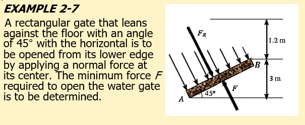

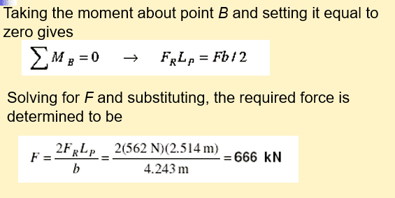

why Fr(Lp) = FB / 2 ? can someone help to explain ?
shouldn't it be 2FB = Fr(Lp) ? since FB act on 2 sides of the gate ...[/B]

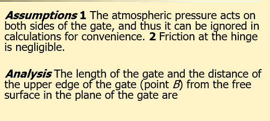

  • Yellow-background text box with bold headings Assumptions and Analysis; it lists assumptions about atmospheric pressure on both sides of a gate and negligible hinge friction, then begins an analysis of gate length and point B's distance from the free surface.

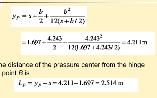

  • Worked calculation of pressure center depth: yp = s + b/2 + b^2/(12(s + b/2)) gives 4.211 m, then Lp = yp - s = 4.211 - 1.697 = 2.514 m.

  • Handwritten-style slide showing moment equation: sum of M_B = 0 gives F_R L_P = F b/2, then F = 2F_R L_P / b = 2(562 N)(2.514 m)/4.243 m = 666 kN.
It's Fb/2 because F acts at b/2 from the hinge. It only acts on one side.
Fr acts at Lp from the hinge on the other side.
Author sure has a funny way of drawing a 45 degree angle !
And conspicuously does not draw a hint of a hinge at B.
Furthermore, the horizontal line at 3 m is supposed to designate something sturdy that has water above and air below ? Quite something different from the liquid surface at 4.2 m; more like the stuff the gate itself should be made of. Deceptive drawing, incompetence, sloppiness ?
