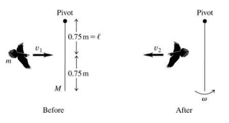

A uniform, 4.5-kg, square, solid wooden gate 1.5 m on each side hangs vertically from a frictionless pivot at the center of its upper edge. A 1.1-kg raven flying horizontally at 5.0m/s flies into this door at its center and bounces back at 2.0m/s in the opposite direction. (a) What is the angular speed of the gate just after it is struck by the unfortunate raven? (b) During the collision, why is the angular momentum conserved, but not the linear momentum?

Can you provide a diagram? Could you also provide the wording of the problem exactly as written? Thanks.
AM
I can provide a diagram from the solution
sorry for not double check it before I post the question. Already edited the exact wording for the problem.

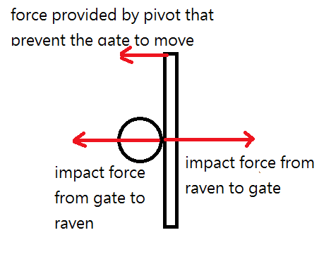

This is what I come up with
am I correct?
Tissue said:
This is what I come up with View attachment 99291 am I correct?
Yes, that's the right diagram. Now you need to use conservation of angular momentum about the pivot. What is the raven's angular momentum about the pivot before impact?
So the two impact forces of raven and gate are not classified as external force because they are inside the system (gate + raven) And the only external force is the force provided by the pivot. So that linear momentum is not conserved. I think I mixed up the conservation of momentum by divide the system into the gate and raven, so the force of the gate is balanced, therefore linear momentum is conserved. Thank you.
