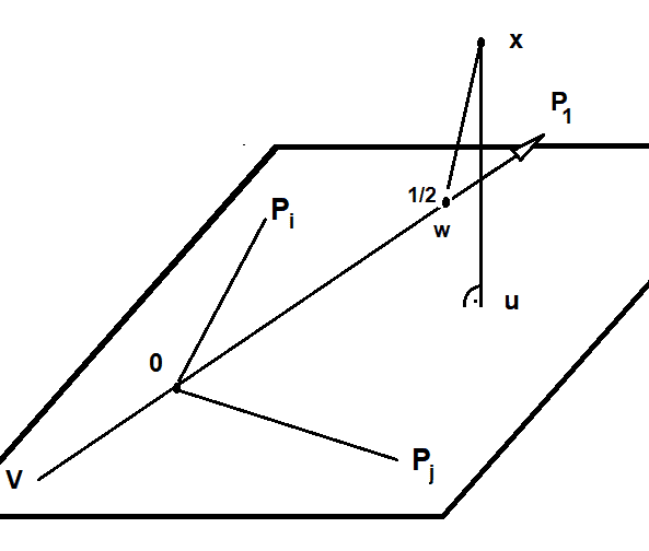

What we have is a hyperspace ##V## and a point ##x## outside. The shortest distance is at the basis of a normal vector of ##V## pointing to ##x##, or a perpendicular vector to ##V##. (I would look up the Gram-Schmidt procedure, but maybe it's easier, e.g. Lagrange multiplier, basis of ##V##, power series for ##u## - just to name a few ideas). Your solution is probably correct, but why?
You lost me. I am familiar with Gram-Schmidt (reconstructing orthonormal basis functions from ones that are not necessarily that) and Lagrange multipliers (optimization with a constraint, setting the gradients equal, yielding system of algebraic equations) and of course power series, which for you would perhaps be ##u = 1/2 - x + HOT## (Higher Order Terms).
But how do these help/are relevant?
I don't know. How do we find ##u \in V## such that the distance to ##x## is minimal? The major difficulty is to describe ##u## somehow. A basis is a possibility. Legendre polynomials work on ##L^2([-1,1])##, but I'm sure there is also a known basis for ##V##. Or you prove, that any other vector ##u(x)= (\frac{1}{2}-x) + v(x)## is necessarily further away, unless ##v(x)=0##. We could write ##u(x)=(\frac{1}{2}-x) + \lambda v(x)## and treat ##\lambda## as Lagrange multiplier.
Since I don't have a solution in mind, I just name ideas.
Edit: ##\dfrac{1}{n!} \dfrac{d^n}{dx^n} (x^2-x)^n\; , \;n>0## looks like a basis.
Edit##^2##: The first basis vector is ##2x-1##, and if we solve ##u^2+ux=0## (the condition that ##u## in ##V## is the perpendicular point to ##x##) with ##u=\lambda\cdot (2x-1)##, then we get ##\lambda \in \{\,0,-\frac{1}{2}\,\}## and ##u(x)=-\frac{1}{2}(2x-1)## is exactly your solution.

Otherwise I think I follow you, but let me summarize: Given the aforementioned basis, we take the first term to approximate ##u : u=\lambda(2x-1)## and substitute this into the equation ##\langle u,u+x\rangle = 0## and solve for the coefficient ##\lambda## (note ##\langle u,u+x\rangle = 0## is equivalent to ##B(u,u) + l(u) = 0##). The linearly independent choice is ##\lambda \neq 0 \implies \lambda = -1/2##. But I don't see how this minimizes ##B(u,u) + 2l(u) = 0##.

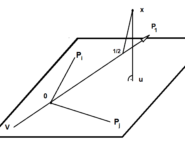

It doesn't show that's the optimum, it only indicates a way to do so. You have to contribute a little, too.
Say we name the polynomials ##P_n=\dfrac{1}{n!} \dfrac{d^n}{dx^n} (x^2-x)^n##. Then we already know that the shortest distance between the straight ##\lambda P_1## and the point ##x## is at ##w## for ##\lambda = \frac{1}{2}##. The situation is as follows:
Now which possibilities do we have? First of all, I think the basis polynomials are orthogonal, so this might help in calculations. I haven't calculated their norm either, but I don't think we have to norm them in case they aren't already. I also don't know whether they form a basis. They should be linear independent, but do they span ##V##? Do we even need this? Anyway, we want to show ##w=u##. So our options are e.g.
  • Calculate the angels, as ##u## is the unique perpendicular to all vectors in ##V ##. Does ##w## have this property?
  • Vary ##w + \mu P## for some vector ##P\neq P_1## and show that the distance becomes larger for ##\mu \neq 0##.

I edited my previous post while it was in your cache. We don't know enough yet about the properties of the ##P_n##. I think orthogonality is easy to show, but I haven't done any property checks for them. I would try to show that ##w## is optimal (2nd option). We know that ##P_1## can be expanded to a orthonormal system, which should do.
