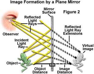

If light bounces from a mirror into your eyes it's from 1 object (the mirror) if i were to have 2 objects placed somewhere then why would the one placed further look smaller in the mirror? The light is bouncing of the same object right?(the mirror) thanks for the help and sorry for the bad english thanks

An object in a mirror appears to be behind the mirror- the same distance behind as it is in front of the mirror.
Thus, if object A is farther from the mirror than object B, its image will appear to be farther behind the mirror than the image of object B, so smaller.
A flat mirror reverses the direction of the light, but the divergence and angles of the rays stay the same. The end result is that objects appear the same size in a flat mirror as they do if you were looking directly at the object. (As long as the distance the light travels between the object and your eye is the same in both cases)
Do these pictures help?
http://cnx.org/content/m42456/latest/Figure 26_02_06.jpg (This picture is large, so I didn't insert it into the thread.)
