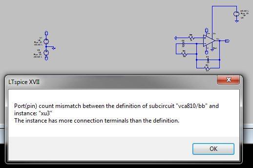

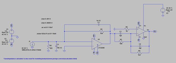

Hi. I have a simple circuit with a third-part model. As far as I can tell using info from the internet I have everything correct, but I still get this problem. Please help me clear this log-jam, thanks!

Can you upload a screenshot of your schematic? And maybe your SPICE deck for the model?
Thanks for the quick reply! Here is as much as I can find you might need.

When do you get the mismatched pin count error? When you try to run a DC or AC analysis? Does it specifically say it is for that device?
Can you run the rest of the circuit without the 2nd amp and there are no problems? How about just the 2nd amp by itself with its circuitry?

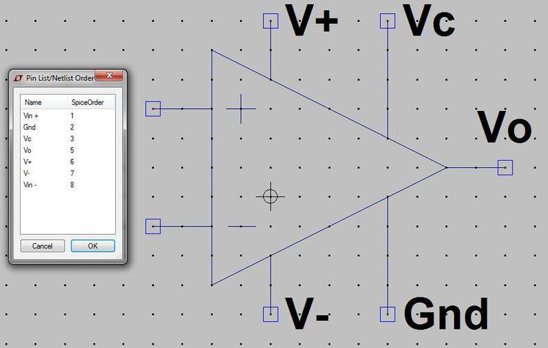

BTW, pin 4 seems to be missing in the part description. Is it a No-Connect pin on the actual part?
Hi Berkeman, thanks for your help.
I had no problem with the first amp by itself, then I added in this third-party model.
I assume since the LTspice model has the same number of pins as the definition it shouldn't be a problem since it is so common. I have not looked at the actual part but I assume it must be an nc.
AC and DC analysis both give the same error.
What is odd is that ltspice says the symbol has too many pins. Where?

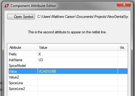

I added a dummy #4 pin in the symbol and and inserted the same in the spice model; it runs! Thanks for hint.
In the absence of true knowledge I can live with a workaround.

A subcircuit in spice is like a subroutine or a function in a programming language. The technical term for the number of parameters passed is “arity”.
The node numbers of the signals connected to a subcircuit are passed as parameters. When the arity differs between the model.sym and the model.sub then LTspice can tell you, but it can't fix it. You need to know that something is very wrong and you need to fix it.
When you import a foreign spice model.sub to LTspice, the arity may be the same, but the order of the nodes may be different. LTspice can tell you if the arity is wrong but it cannot tell you if the parameter order is different. That most often happens when five terminal op-amp models are imported from other manufacturers libraries.
The other trap to watch out for when importing subcircuits is identifying connections to ground inside the model that do not have an external node such as Com or Vss. You must work out why they are there and if they are sensible.
