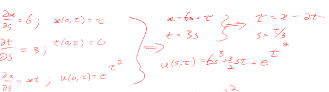

integral[du]= Integral[xt ds]
xt=18s2+3sT
so,
u=Integral[18s2+3sT]
u=6s3+(3/2)s2T+C
C=eT2
This is what I did and the solution is below. I'm unsure where the missing power on the (3/2)sT went in the u(s,t) equation.[/B]

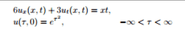

Let's make the initial image somewhat readable:
You reaaly need to give a complete statement of your problem in the body of your initial post. Here, are we to assume that you are asked to solve that PDE with the stated initial condition?
The goal is to solve the cauchy pde.
