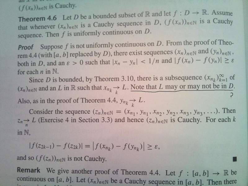

Mistake in my analysis book ? Or am I missing something ?

Please review the attachment.
Why can L be OUTSIDE of D ?
[tex]x_n \in D[/tex] and D is bounded. So doesn't that mean that any subsequential limit of [tex]x_n[/tex] has to be in D ? Btw, Theorem 3.10 is Bolzano Weierstrass.
Theorem 4.4 Says that A continuous function on a closed interval is uniformly continuous there.
I think I understand now.
They said that D is bounded by not closed. i.e suppose D = (a,b)
[tex]x_{n_k} \to a[/tex] could happen and a in not in D.
Is this correct ? Anyone ?
What you said is right. Also, the bounded subset need not be an interval of reals; for example, the subset could be all the rational numbers from 0 to 2. Then there are an uncountable number of points not in the set that are the limit of Cauchy sequences inside the set.
Perfect. Thanks.
