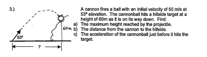

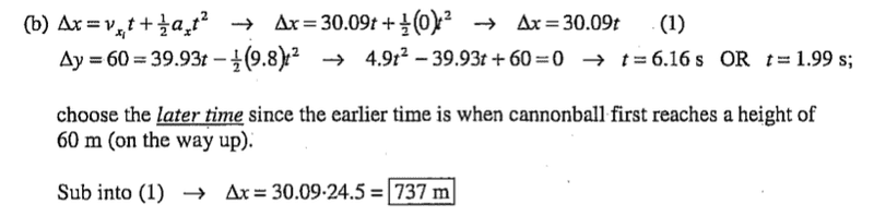

Please look at pictures.
Why is it that they use 24 seconds for the time in b)? They get t=6.16s, why do they not plug that into the Dx equation to get 185m of x displacement?
Looks like a mistake.

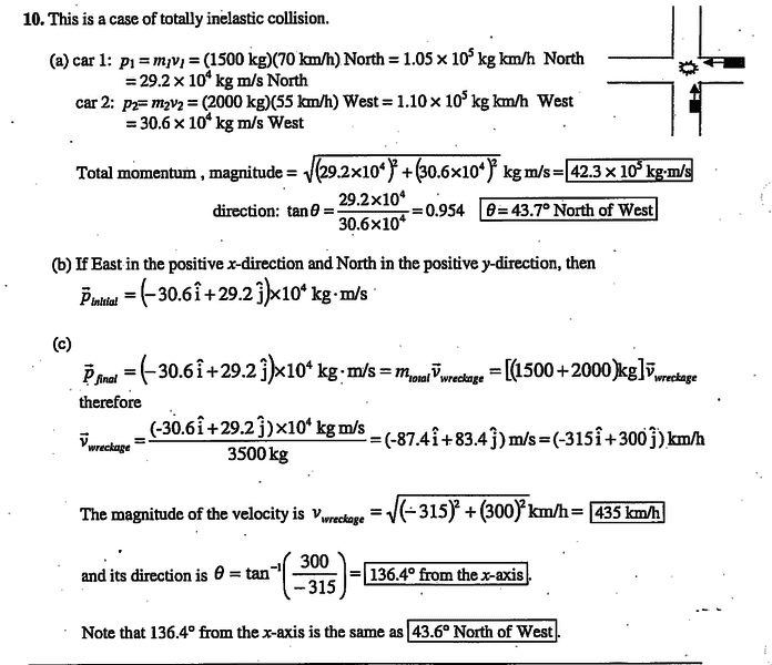

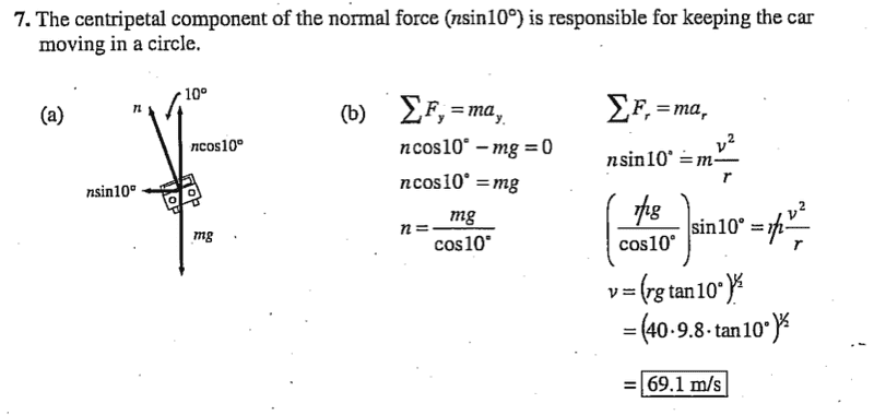

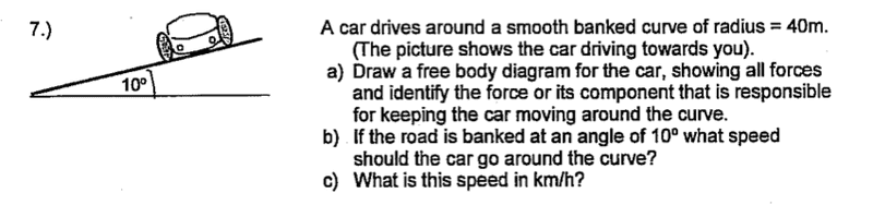

DocAl, is the speed also wrong in this problem? I think they made a mistake right at the end. They forgot to square root?
You are right. They made a mistake.

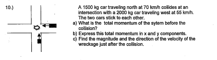

Another mistake spotted?
They made a mistake with the *10^4. Should be 10^3. Angles do not change (they are good).
The final velocity should be 12.07m/s, IE 43.45 km/h.
By the way, should we not express scientific notation with only numbers from 1 to 9? Why do they put 10.1 x 10^4 etc...?
Yes, another mistake.
As long as they do it right, it doesn't really matter. (Though you are correct.) But that's their first mistake: The momentum values are off by a factor of ten: they have 29.2 x 10^4 instead of 2.92 x 10^4, etc.
