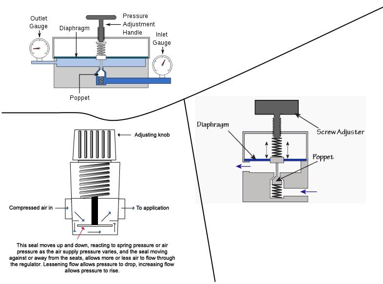

I've always been curious what would happen if I used air valves and regulators to mix different pressures of air together?
For reference I spliced a few diagrams into one here:
Three pneumatic regulator diagrams: a pressure regulator with outlet and inlet gauges and a poppet, a regulator with adjusting knob and compressed air in and to application ports, and a screw-adjusted diaphragm regulator with poppet.

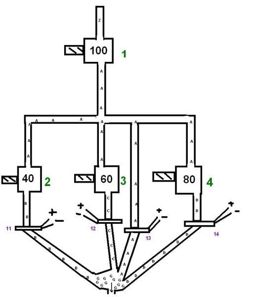

And I made a picture of the setup I'm imagining with some nice labels so we all know what part to refer to!
Hand-drawn schematic of a pneumatic manifold: a 100 regulator (1) feeds a pipe network branching to regulators 40 (2), 60 (3) and 80 (4), each with a valve, and valves 11 to 14 join at a common outlet labelled G.
Assuming the valves are all open, I'm guessing you get 100psi out correct? You can't possibly have more than what you put in?
My main problem is combinations of valves- ie: what happens to pressure "G" if only valves "11" and "12" are open?
Yielding a supply of 40psi and 60psi./
Assume room temperature air, fixed pipe size.. (1/4") I guess..
Anyways, what do you think?
What do those big numbers in the diagram mean?
In general, air pressure somewhere in a system depends on the whole system. If you close the gap at "G" and provide some supply of 60 psi pressure, the pressure can rise up to 60 psi, if air does not flow out somewhere.
The black numbers? Those are the regulators in the first picture.. set to different PSI.
I don't really want to close it off, as the whole point of this would be to use 3 regulators to get 6 different pressures or something.. know what I mean?
Let's assume the output is going to an air tool, a rotary air piston vented to atmosphere upon press of a button..
But just for arguments sake what would happen if you mixed 40psi with 60? Do you end up with 50?
Maybe I'm not considering how those regulators function either.. hmm./
If the pipes are big enough that there isn't much loss and the 60 psi regulator can handle the load, the 40 psi regulator will just close completely.

Looking at the regulator's guts, it seems to me that a lower PSI setting makes it more sensitive to pressure drops. What with the bigger space as you unscrew the adjuster?
So isn't that backwards? Wouldn't the 40PSI supply all it could first?
It shouldn't if the pressure on the output side is at 80 PSI.

The 40 psi regulator wants to see 40 psi and the 60 psi regulator wants to see 60 psi. The 60 psi regulator will open until it sees 60 psi, at which point the 40 psi regulator also sees 60 psi and closes.
Ah! Ok.. gotcha. So they will equalize and not allow the lower values to open anymore..?

Ok, so what about when the situation is as you say.. (40 and 60 open. All other valves closed)
\\\>>Btw.. it's the valves that are doing the open/shut. The reg.s stay as they are. \\\
Would the pressure drop from the air gun cause enough loss to open the 40 slightly?
That is the effect I am going for.. to end up with a middle value perhaps?

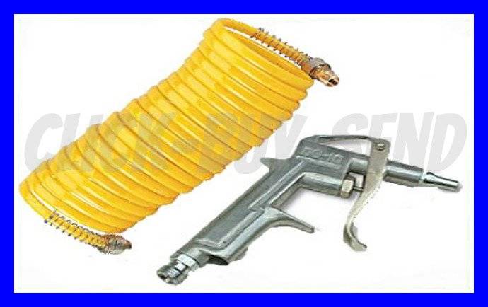

What air gun/what is an air gun?

The 40 won't open until the downstream pressure is below 40. It may have the effect of increasing the available flow volume once the flow rate is high enough to cause the pressure (including losses) to drop below 40 PSI, but that will depend on the details of the entire setup.
Right. Picture being a 1000 words and all that///
This ka-jigger is an air gun:
Yellow coiled air hose with brass fittings at each end, beside a silver metal air gun with a trigger and nozzle.
Basically an open valve to atmosphere..Re: sneak past -->

Goal being to create 50 psi from 40 and 60- I can also toggle the 60 on and off to possibly allow the 40 to assist more or less.. with a controller chip//If I put a certain amount of 60psi air and a certain amount of 40psi air in a closed bottle.. I could end up with 50psi right?
You won't get that in a reliable way with your two regulators alone.
If the container sizes have the correct ratio, sure.

Indeed, when both of them are on the situation prevents the 40 from doing anything.. but when the 60 is shut off then what?
That's when the pressure drops 59..58...51... 48! Then blam! We turn the 60 back on for a fraction of a second.. 55.. 54...51.. ---Etc.
==The bottle scenario is totally imaginary.. as if i could teleport two volumes of air into a sealed container full of nothing but vacuum.

You may be able to do some pulsing with the 60psi regulator to make it appear to give less, but it will be very difficult to pulse it fast enough and under enough control to get a steady 50 psi. And unless you do a really bad job of it, the 40 psi regulator will never open. If it does, you'll just be swinging back and forth between 40 and 60 psi.
