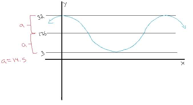

As you said, to find d, (32-3)/2=14.5, so the a going to be: 32-14.5= 17.5? Did i misunderstand something here?
That's my mistake there. In order for the graph to reach a max of 32 and a min of 3, it has to move about a central line that is half way between the two. I don't know what I was thinking when I worded that.
(17.5 + 14.5 = 32) and (17.5 - 14.5 = 3), so 17.5 is the vertical shift (d), and 14.5 is the amplitude.
That's OK, thanks for helping me, there's a BOnus: Assuming still that the leftmost crest intersects the y-axis, write the sine equation to model the wave( this is require accounting for a horizontal translation) Would you help me where to start? Is it about the a going to be (-a)?
You could write it with a negative amplitude sure, there are an infinite number of possibilities for this one. I think the easiest way to go about it would be to consider what it means when the leftmost crest intersects the y axis. That means the wave is in the standard shape of a Cosine Wave! What would you add to the angle of sin(x) to make it look like a cosine wave? (There's an identity for this)
