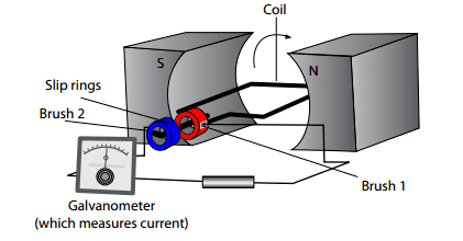

here is a diagram of an electric generator, and a small section of what my lesson was trying to explain:
Diagram of a simple AC generator: a coil rotating between the S and N poles of a permanent magnet, connected through slip rings and brushes 1 and 2 to a galvanometer that measures current.

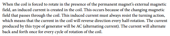

Printed text excerpt explaining that a rotating coil in a permanent magnet's field produces an alternating induced current that reverses direction every half-rotation.

so this was the explanation from my lesson. I undestand that an electric generator produces electricity, and functions opposite to that of an electric motor. According to the excerpt above, the coil is placed within the external magnetic field of the permanent magnets, and it is forced to rotate? how is this possible if the coil does not have a current running through it, the coil does not have a magnetic field to interact with the external magnetic field of the magnets, so there is no force being applied on the coil, right? so then how is the coil rotating?
So then the excerpt goes on to say that this rotation produces an induced current in the coil. Arent induced currents created in conductors by a change in the magnetic field. So which magnetic field is changing, is it the magnetic field of the permanenet magnets? They mentioned that the induced current is created in the coil, due to a changing magnetic field that passes through the coil, where is this 'changing' magnetic field coming from, I am confused?
why does the current in the coil reverse direction every half-rotation??
Can someone please explain how an electric generator works, in terms of how the current is being created within the coil, what magnetic field is changing to cause this induced current, how the coil is rotating to begin with, etc...
Right, there is no force being applied to it unless you DO apply a force to it. If you don't, it doesn't rotate and doesn't generate electricity. How do you apply a force to turn the generator? Ever hear of Hover Dam? Water runs through turbines which turn generators which produce electricity.

Just forget "external magnetic field": I don't understand why they said that! There is a magnetic field from the permanent magnet(s), but this is an essential part of the generator. I think what they really meant is that this permanent-magnet field surrounds the wire loop.

The magnetic field (the only one you should be interested in #1) comes from the permanent magnet(s) which is/are part of the generator.
This passes around and through the coil - but how much goes through the coil depends on the coils position. So the change is caused by the rotation of the coil.
As shown in the diagram, little or no field passes through the coil. If you could see the lines of the field going from the N pole to the S pole, they would, as it were, slide past the coil without going through it. When the coil is rotated 90o then most of the field will go through the coil. (It's a pity they did not draw the field lines on the diagram and show the coil at other positions. There is a diagram here not brill, but better. At least it shows a handle to turn it.)
Again they word it badly. The permanent magnetic field does not change. What changes is the amount of the field which is going *through* the coil - what is sometimes called, "linked" to the coil. So as the coil rotates, the amount of magnetic field through the coil changes, so a voltage (#2) is induced in the coil. Depending on the direction of the field and whether it is increasing or decreasing, you get a positive or negative voltage. When it is changing quickly you get a larger voltage: when it is changing slowly you get a smaller voltage.#1: There is the Earth's magnetic field, which really is caused externally to the motor, and there may be other stray fields around from other magnets. They will be much weaker than the permanent magnet field and should be ignored.
#2: BTW a changing magnetic field through a coil induces an emf or voltage. There may or may not be a consequent current, which is determined by this induced voltage and the total resistance of the complete circuit, if in fact there is a complete circuit.
They say that, "this induced current opposes the motion ..." , which is correct if there is a current. If no load circuit is connected, no current flows and there is no resistance to rotation of the generator (other than friction.) Try this when you get a chance!
