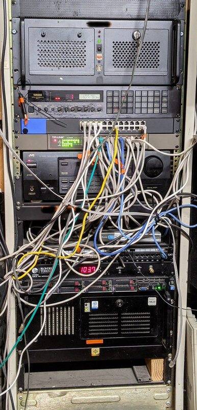

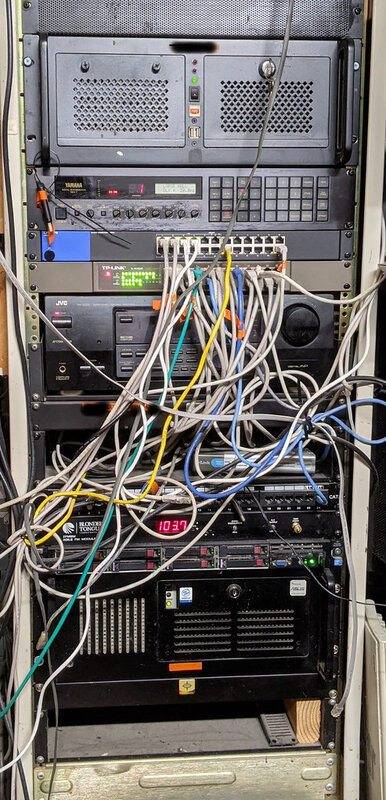

dlgoff said:
Nice garage and rack.
When I was young, "nice rack" meant something else. But I digress.
