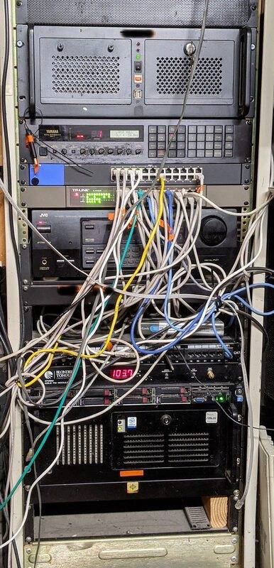

My main personal work stations are surplus diskless HP ProLiant DL360 G7 1U 12 core 64-bit Servers running 64-bit Linux Debian remote boot over the network to a main 12 core DL360 G7 with a 8 SAS drive raid and 4 port 1Gbit ethernet for remote NFS mounts to the workstations.
A typical surplus under $200 system: HP Proliant DL360 G7 12 Core Server [ 96G PC3 RAM - 4TB HD - 2x 2.40GHz ]
https://h20195.www2.hpe.com/V2/Getdocument.aspx?docname=c04284501
A physically (workshop on the house lot) separate computer system uses Bacula to backup the main server and other computers to internal 10TB mirrored drives and external 10TB USB-C raid storage pools. It automatically selects incremental and full backups.

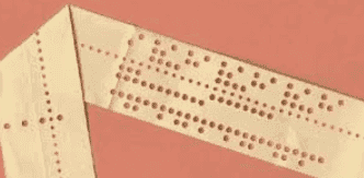

I think back to the first backups I made. They were paper tape. The tape might still be in good condition, but try finding a paper tape reader today, and try to find a computer that can run those executable files and source programs (with their dialects and OS dependencies).
We also had magnetic tapes in those days, but they had the same problem. Lots of luck finding a way to read those tapes today.
Migration might include changing file formats and rewriting source programs.

The disk-less server class workstations with upgraded video cards are very quiet at idle with a proper Linux fan-control daemon. The main servers, online UPS and house networking on are an old DEC rack in the garage so noise is not a problem there.
I've mainly used physically redundant hard-drive based backup systems with limited offsite backup to sites like github for sharing ongoing projects.
