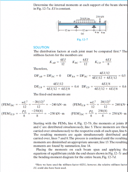

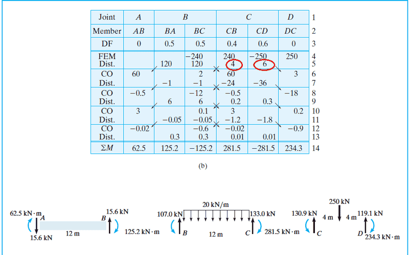

For the circled part , i don't understand why it's 4 and 6 . I know that it's about distribute the moment according to the ratio that we have determined earlier .
For 4 , shouldn't it be 240*0.4 = 96 ? For 6 , shouldn't it be 250*0.6 = 120 ?
Seems to me that the process is
  1. Take the number in line 4, negate it, and in line 5 redistribute that between that column and the other column for the same node in proportion to the DFs for those two columns. Some line 5 entries will be the sum of two such redistributions.
  2. Transfer half the number in line 5 to line 6 in the neighbouring column of the adjacent node.
So at the point you query we have -0.6 x 240 - 0.6x(-250)=6, etc.
