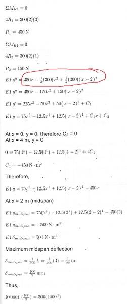

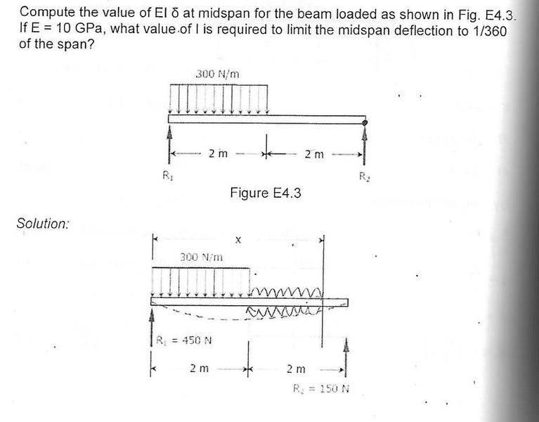

refer to the circled part , i don't understand the author's working .
I think it should be 450x - 150(4-x) -30092)(x-1) , correct me if I'm wrong . (taking moment about x ) ...
is the author wrong , coz the distributed load start from R1 to 2m from R1 ...

No, the author is not wrong.
The bending moment function EIy" is carefully constructed to show that the distributed load starts at x = 0 and runs to x = 2, after which an equal and opposite distributed load is applied to the beam at x > 2, so that the net distributed load is zero.

why ? i still don't understand , i can only understand the 450x , why should be -0.5(300)(x^2) +0.5(300)[(x-2)^2 ]

i don't understand why it is -0.5(300)(x^2) +0.5(300)[(x-2)^2 ] , can you explain ?

why it's 0.5(300)(x^2) ? the 300N/m only 'defined ' from R1 to 2m from R1, am i right ? why shouldn't it be 0.5(300)(2)(x-2) instead? as you said , after 2m , net distributed load is zero

the location of 300n/m is at R1 and extend to 2m from R1, so ,the EIy" should be = 450x-300(2)(x-1) ?
why there's -0.5(300)(x^2) +0.5(300)( (x-2)^2 )?
I'm confused
Or do you mean the 300(X) force still exist at X >2?
