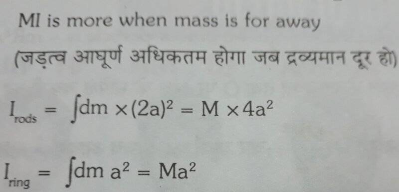

Calculate the Moment of Inertia of each and determine the greatest:
MOI=mr2
This was the question
(The line below is probably some translation of upper line in different language)
For disc it was ma^2/2
For ring it was ma^2
For square lamina it was 2ma^2/3
For rods
It was different
Please explain
Thank You🙏
I don't know what was being calculated by this equation
The hand-written calculation is a little messy and hard to follow, but it looks correct for the 4 rods making a square.
It probably calculated the MOI of the system (because it was the solution given in the booklet)
Also my MOI came out to be
(m/4)×(8a^2)÷12 + 2×(m/4)×a^2
[About x and y axes]
(ma^2)+(ma^2)/3
{About z axis}
Ok, you are saying that ##I_{\rm x\, axis} = I_{\rm y\, axis} = \frac{m}{4} \frac{8a^2}{12} + 2 \frac{m}{4}a^2##
That looks correct.
It would be nice to simplify the result.
Aurelius120 said:
(ma^2)+(ma^2)/3
{About z axis}
Here you are using ##I_{\rm z\,axis} = I_{\rm x\,axis}+I_{\rm y\,axis} = 2I_{\rm x\,axis} = ma^2 + \frac{ma^2}{3}##.
This looks correct. Of course you can simplify this result to just one term.
