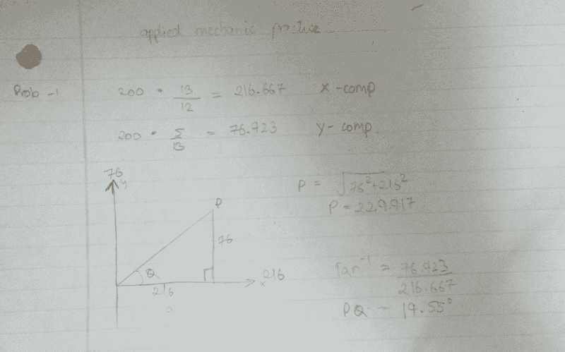

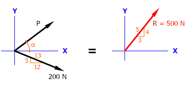

Two Forces are acting concurrently and their resultant is 500 N as shown in figure on the right. Determine P and the angle P makes with the x-axis?
2. The attempt at a solution
Is my answer correct?[/B]
I'm afraid it isn't. For one, you're x-component is larger in magnitude that the original force. And you haven't made use of the resultant of 500 N.
Use an equation such that the resultant of 'P' and the 200N vector is the 500N vector.

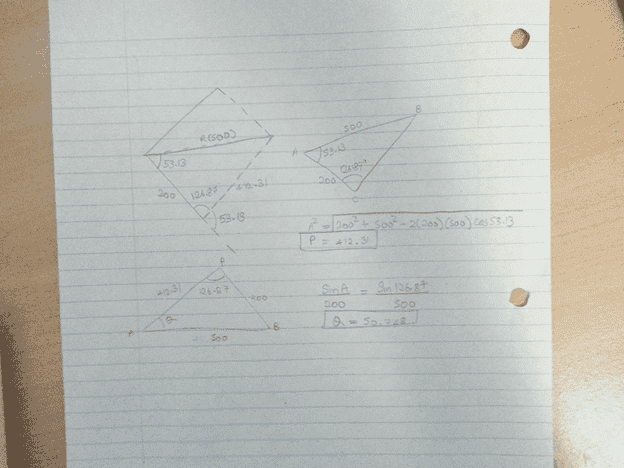

I think this is what you mean.
I got the answer. :D
