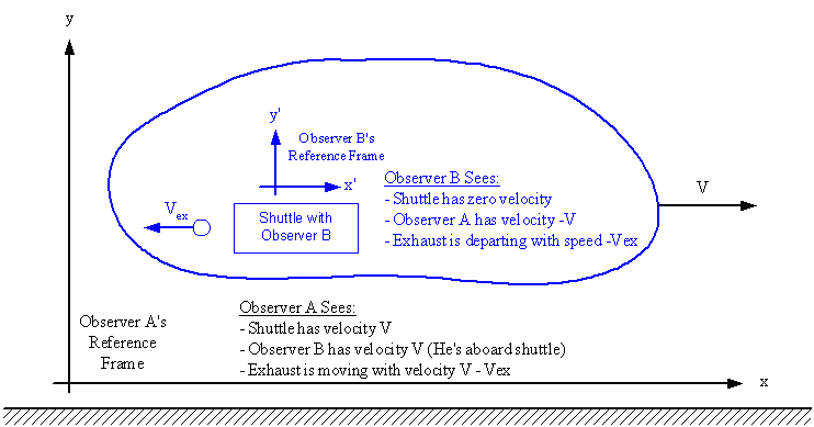

If Vex has negative direction respect to shuttle so V is positive then observer will see exhaust with (V-Vex) it means that we assume rocket is not moving at that time when exhaust moving with relative velosity?!
Imagine that there are two observers. Observer A is located on the ground, watching the rocket move at velocity V (according to him). Observer B is located on the shuttle and therefore moving along with it. Observer B watches the exhaust shoot out the engine nozzle with speed Vex according to him. According to B the exhaust has velocity -Vex in his frame of reference. Observer A still sees the shuttle (and observer B along with it!) moving at velocity V. Observer A will see the exhaust moving at V - Vex. If you want to could say: VexA = V - Vex, that is, the velocity of the exhaust gas at that instant in the reference frame of observer A is V - Vex.

Please just imagine two cars x and y are moving at the opposite direction Vx=60 km/h then Vy=-50 km/h . Velocity of x respect to y is 110 km/h and velocity of y respect to x is -110 km/h it means that Vy_x=Vy-Vx=-50-60=-110 OK ?! so I think for observer B Vex equals Vex-V
The other problem I have with this is that when there is a mass of -dm velocity is v+dv so momentum of shuttle at t+dt is Pf=(v+dv)*(m+dm)+(Vex-(v+dv))*(-dm) Pi=m*v
but I don't know why in the equation there is no dv in momentum of exhaust ?!
If Observer B is aboard the shuttle, then according to him V = 0; The shuttle is not moving with respect to himself, and he sees the exhaust leaving with velocity -Vex.
If the calculation is being done in the frame of reference of the rocket then the exhaust velocity is a constant.
