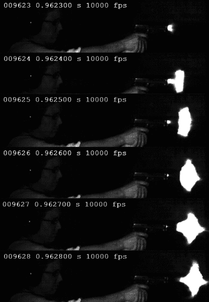

Another point that is missed in idealized textbook problems is that the recoil of the pistol is equal and opposite not only to the momentum of the bullet, but to the momentum of the bullet plus the momentum of the expanding gases that propelled the bullet (at least the component in the same direction). This complicates accurate computation of pistol recoil considerably and renders simple formulas based on bullet mass and velocity a significant underestimate.
The attached photo shows stills from a high speed video taken in our lab to try and better quantify the contribution of the gases. The frames in view do a pretty good job showing the forward motion of the gases. Later frames (not shown) allow quantifying the subsequent rearward motion of the pistol. Bullet velocity was measured with an optical chronograph.
