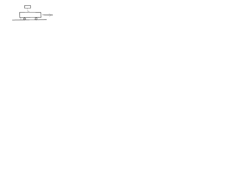

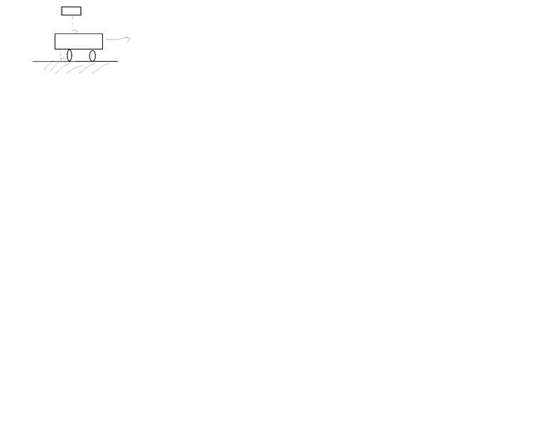

Could someone please explain, in terms of the momentum, a rail car slowing down if an
item is dropped vertically downwards on to it. Thanks.

The object and train are perpendicular to the ground.​
Please show some work.
I doubt the train is perpendictular to the ground. Is it vertical and riding on its caboose?

The explanation given describes the interaction between the vertical side of the cart and the rock dropped, but what if there is no interaction between the two and it is dropped, say, in the middle of the cart? While I am writing these words, I am thinking that at the moment it hits the cart, the rock will move to the right, creating a leftward force on the cart (using Newton’s 3rd law), slowing the cart down. Presumably the interaction here would the friction of the floor of the cart and the rock.
If the rock ends up moving at the same horizontal speed as the cart, then there must have been some interaction that accelerated the rock horizontally. For the final speed of the cart the details of that interaction do not matter.
