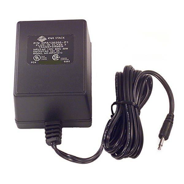

I would like to do some monitoring of power line conditions. To start with, I just want to monitor and record the voltage wave form on the two split phases. I would dedicate a small computer to the purpose. The idea is to reduce the voltage from the power line in a safe way and feed that through the audio input of the computer. A program would then capture that audio input, compress it in a lossless manner (a 60 Hz sine wave should be very compressible), and store it on disk space to be fetched by another computer over the network on a regular basis.
I'm not sure what I will get out of it. But I just want to tackle the issue of getting it in a reliable and safe way for now. In particular, I want to know what method might be best for reducing the voltage and still not alter the waveform any more than would be acceptable. Would a transformer be adequate for this, especially if it is kept well away from the saturation level? Or would it be best to have a resistor divider network?
I don't even know what impedance and levels the audio inputs have, yet. But I know I don't want to go buy the off-the-shelf device I once saw, since it could not be automated as I would want (had to manually move a memory device from the unit to the storage computer, which would apparently also mean a gap in measuring), and it would cost $3500.00 for this inconvenience. I figure I could do better with $50 of parts and an old used netbook worth maybe $100 today (and feel safe about fetching the data via wifi).
One motivation to do this is that at different times, I detect behavior of different devices changing, presumably due to changes in the electricity. Sometimes my UPS clicks over to battery and back off again. Was there a transient? A couple lost cycles? Sometimes my lights just dim for a while. Sometimes my fan in the floor pumping air into a small room I use for a couple computers will slow down and speed up. These different things do NOT happen at the same time so I am curious about this. Voltage change? Transient? Frequency change?
Any suggestions to set up power line monitoring like this?

The easiest starting point would be to use two AC "wall wart" transformers like in the picture below. You don't need a high current one like in the picture, though. You will likely want to attenuate the output down to whatever the sound card's input voltage range is.
Sounds like an interesting project. You may want to look at other commercial AC Mains power monitoring equipment datasheets, to see what kinds of things you should look for (surge, sag, cycle dropouts, etc.).
Black plug-in AC wall transformer with a label reading P/N DPA120200-P1, Class 2 transformer, input AC 120V 60Hz 40W, output AC 12V 2A, with a cable and a small barrel plug on the end.
""Would a transformer be adequate for this, especially if it is kept well away from the saturation level? Or would it be best to have a resistor divider network?""
A transformer such as Berkeman suggested gives you a VERY significantly safer hookup.
You mentioned avoiding saturation, which is a good idea to mantain fidelity.
To that end if you could find 230 volt step down transformers, on 115 they'd be operating at half flux.
Furnaces use a 230::24 control transformer. They're not prohibitively expensive at a good hardware store.
Looks like a good idea. How can I verify that these devices do not include things that might alter the signal accuracy, like filters? Ideally a straight transformer with nothing added would seem right. I do want a wide bandwidth, at least to the Nyquist limit on my current sampling rate (48 kHz sample rate, so 24 kHz bandwidth). That should not be saturation issue (even below 60Hz as long as it is not a strong signal).

Good idea. I was looking at some buck-boost transformers, as they usually have a pair of 120V windings for primary that can be wired in series. But those are typically well north of $100.

"" Nyquist limit on my current sampling rate (48 kHz sample rate, so 24 kHz bandwidth). That should not be saturation issue ""
oops - i thought you were speaking of magnetic saturation in the transformer cores. That's why i suggested the furnace transformers operated at half voltage.

Oh, I did mean magnetic saturation of the core, too. I don't want a 50% swell to be distorted.
FM might be a workable method, too. That should not be too hard to "decode". But something that can give me a lot in a limited bandwidth would be good, too.
The smaller I can make the power sensor, the less is exposed to possible power damage. The more isolated it is, the less the risk of a shock hazard somewhere. A small circuit that can fit inside a small wall wart, with an LED on the front to emit signal, would be good isolation. I was thinking along such lines once when I wanted to do a current transformer, given the even greater hazard these things can have if they go open circuit (fuses don't play well with these).
