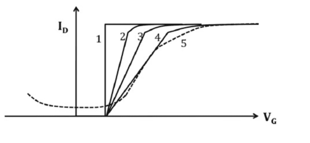

Below graph shows the I - Vg curve for different MOSFET, which curve is impossible for MOSFET?
I - Vg
Homework Statement: Below graph shows the I - Vg curve for different MOSFET, which curve is impossible for MOSFET?
Homework Equations: I - Vg
I am inclined to select 1), as it is not likely to have a sharp transition from subthreshold to Quadritica region. However, graph 5 also looks strange, since it somehow shows current in at subthreshold region. I am therefore confused about whether it should be 1) or 5).

I would agree. Could be either.
Tom.G said:
Curve #5 reminds one of reverse breakdown (due to Electron tunneling) of the gate oxide.
You can't tunnel with zero Vgs!
