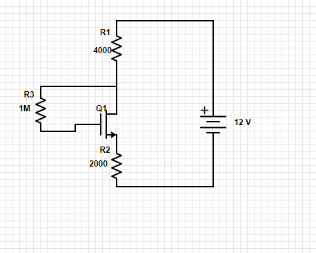

For part A,
My initial assumption was that since we are trying to find the DC bias current(to help find K), we would use the large signal, where capacitors are treated as open circuits. The new equivalent circuit is:
Then, I thought it would be a simple KVL problem because the is no current at the gate, such that,
Ir3=0.
Thus,
(4k+2k)Id+4-10=0
and Id=1mA.
Again, since Ir3=0, that means Vgate=0 and Vgs=Vgate-Vsource=0-(1mA)*(2k)=-2V
That would mean Vov=Vgs-Vt=-2-2=-4V[/B]
This would mean that Vds>Vov, which means the mosfet is in active region and the
equation
Id=K(Vov)2 cabn be applied.
Thus K=(1mA)/(-4)2=62.5 μA/V
I am sure this is completely wrong, but it is all I have at the moment.
With B, I am not sure how to accomplish this. I have been googling, and it stated I needed the DC and AC load lines. My DC load line was:
Id= (1/600)-Vds/6k
but that is all I have.
Please, any assistance wou;d be greatly appreciated.
DragonChase29 said:
Id=1mA.
Good so far. In fact, nicely done.
Whence this? If there is no current thru the 1 meg then what does the gate voltage have to be? Fix this & we can continue.
rude man said:
Good so far. In fact, nicely done.Whence this? If there is no current thru the 1 meg then what does the gate voltage have to be? Fix this & we can continue.
Wait... If there is no current through the resistor, the gate voltage has to be 0. I'm sorry, maybe I am not understanding something...
LOL... just figured it out. Since the voltage across the 1Mohm resistor is Vd-Vgate, if the current is 0 amps, then Vgate=Vdrain, which is 6V.
Then, Vgs=4 V and the active equation still applies
K=Id/(Vov)2=0.25 mA/V

DragonChase29 said:
Now onto part B, which is really confusing me. Any resources?
Were you given values for C1 and C2? This part can only be solved given C1 and C2, together with the operating frequency. That's because the 1 meg feedback resistor plays a part in the answer to some extent depending on the above parameters.
What you can otherwise do is assume high values for C1 and C2. In which case the 1 meg plays no part. Just apply a sine voltage about the dc value of Vg which you have calculated in (a) and solve for Id and consequently Vd.

DragonChase29 said:
I am sorry...I don't understnad this. Vary the gate voltage...How do I know when I clip the sine wave?
Make a graph of Id vs. Vg: Id = K(Vg - IdR1 - VT)^2, then Vout = Id*R2.
There is however a problem: this circuit will not give you a sine wave output for a sine wave input if you assume C1 = C2 = infinity. So the answer would then be that only very small sine inputs give a quasi-sine output. To determine how small you have to compute Id(Vg) and see under what condition Id is somewhat linearly related to Vg. I have the answer if you get that far.

DragonChase29 said:
Thanks for all your help, rude man. Unfortunately, I still am not understanding the method that you are describing. From what I was told, I would need the DC load line and the AC load line. I don't know how to get the AC load line and what to do after
I've never been too crazy about load lines. Not sure they're even appropriate here since the cicuit is nonlinear. In any case, one way or another you have to effectively do what I wrote in my previous post: graph Id vs. Vg, then Vout = E - IdR2 with E = 10V.
There is a small-signal gain which I think you mean by "AC" which you calculate by taking ∂Id/∂Vg after you get your expression for Id in terms of Vg and VT. For your circuit this gain is ∂Id/∂Vg = 0.67/R2.
