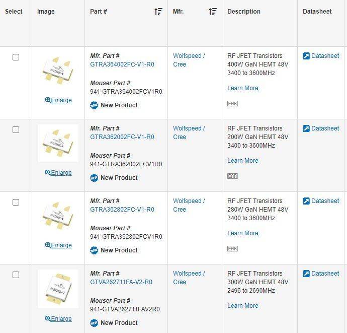

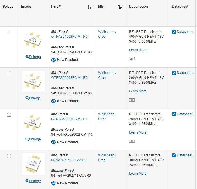

Looking at the list on the sales page, there are several types of RF transistors, including bipolar, JFET and MOSFET.
https://www.mouser.com/Semiconductors/Wireless-RF-Semiconductors/Transistors-RF/_/N-ax2e7

Yes, but the question was about power amps. This is mostly the domain of MOSFETs now days, unless the frequency is really high (GaAs, GaN, etc.). I've never heard of a power JFET.
Did you not read any of the data in Alan's link ?
They show many high power, GHz frequencies JFETS :smile:
here's just a few of them...

Oops, yes you're correct. I tend to put the GaAs, GaN, and SiC devices in a different category, but yes they are JFETs. I was thinking of Si devices.

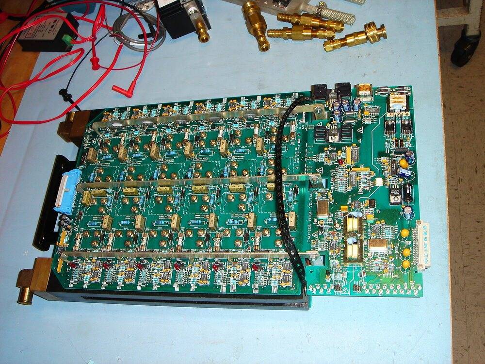

I once designed a very large linear power supply which was made of 48 large MOSFETs (SOT-227) in a series/parallel arrangement. It was water cooled and could (was supposed to) dissipate 5KW of heat. It was very reliable (with N+2 redundancy) and is still in production. Trust me, you can operated MOSFETs as linear devices.
One issue I had was that I designed for a 200KHz bandwidth, but had to deal with some parametric (i.e. sharing) oscillations at frequencies as high as 200MHz with these devices, which were not intended for RF applications.
edit: BTW, there are some large MOSFETs with multiple die that do not work well in high power linear applications. This is about device construction and selection and not intrinsic to the MOSFET dice.
