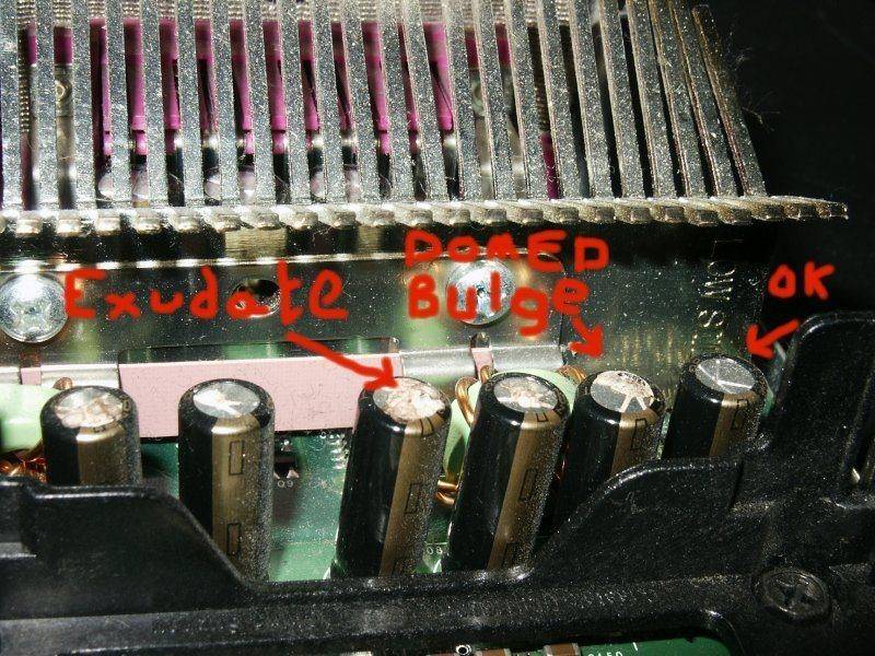

For those EE that have heard of, but not seen, here is a photo of capacitor failure on a motherboard.
I have labelled the relevant material.

Were you fixing it at the time? :biggrin: (see your footer)
Did the supply overvoltage to cause that?
Rumbled!
:smile:
No, this mobo (probably) died of heatstroke.
I've got one too. Maybe I'll post a pic of that later today.
One aspect of capacitors I never see described is current capacity. They only have a voltage rating. Could it be that for a given capacitance, voltage, and frequency, they can always handle the current that would be involved continuously? Or is there really a limit?
If these capacitors overheat, isn't that more directly an issue of current flow? If the metal inside is too thin for the specified usage, they would get too hot, right? Then there should be either an ambient temperature limit, or a heat rise rating. But that can also depend on air flow, etc. I so often seen gangs of little capacitors all tucked together. That doesn't let the heat early and we end up with the magic smoke being let out later.
Not in this case.
T'was a seriously abused pc, running 24/7 and the environment inside the case just too hot for too long.

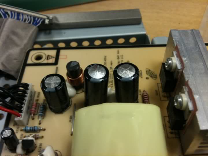

I thought it was basically a late 90s, early 2000s sort of problem, but I had to replace cheap bulged caps in the power supply board of an LCD (Samsung 205BW) from 2007 with high-temperature, low ESR, and high lifetime ones (Nichion).
I generally like Samsung products, but I hear this is quite an endemic problem with them.
For those of you in a similar predicament, this site was quite helpful:
http://www.badcaps.net/forum/showthread.php?t=11439

hey what about the condition of that 1st one from left in the first pic?
Same thing as in the others: exuded electrolyte (or a really dirty camera lens)
