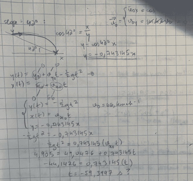

How do you find the time in the air of an object kicked horizontally from a slope of 42º, knowing the speed?
x = xo + vot + 1/2gt^2
Hi!
I am really stuck on the concept, wouldn't we not have enough variables?
I tried equation the equation for the y of the object to the slope of the hill, but I am missing several variables.
Any help is greatly appreciated :)

Yes I drew a sketch and I have :
y(t) = yo+vo t-1/2 g t^2
y = -0.743145 x (with angle 42, sorry that was a typo)
x(t) = xo + vxo t
I really don't know where to go from here?

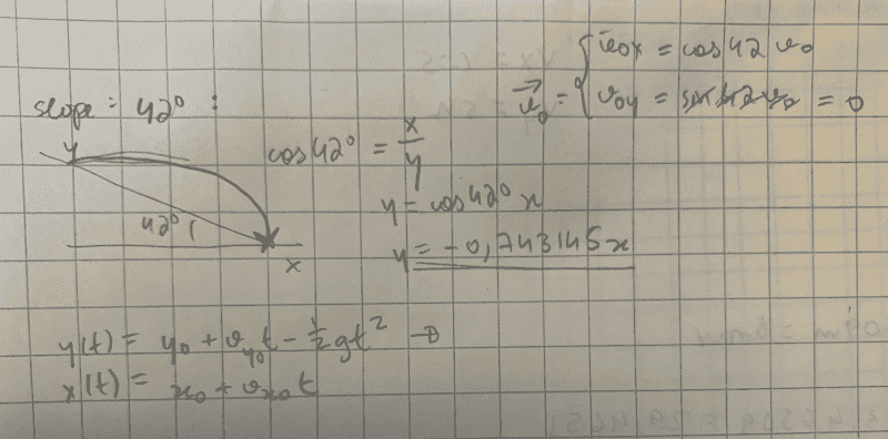

Just to be sure, could you show us your sketch ?
Sure, here it is :
PeroK said:
Your equation for the slope already assumes the top of the slope is the origin, right? In any case, you get to choose where you put the orgin. The top of the slope where the projectile starts seems simplest.
##v_{0_x}## relates to the projectile. It has nothing to do with the slope.
Okay that clears things up a bit. I tried putting the y equation for the slope equal to the y equation for the projectile, but got a negative t :
Where did I go wrong...?

But, you've given an answer in seconds? What unit of time are you using - hours or seconds?
In terms of where you went wrong (apart from that), all I can see is a bunch of numbers. It's hard to see. The answer,obviously, can't be negative, so maybe you should sort that out as well. And see what you get next time.
Personally, I would use some algebra, as it makes things much clearer than a bunch of numbers.

##\cos(42^o)=\dfrac{x}{\sqrt{x^2+y^2}}~##, not what you have (##=\frac{x}{y}##).

If the conversion is the only correction you make, your answer will still be incorrect because the relation between ##x## and ##y## in your solution is incorrect as it stands.
