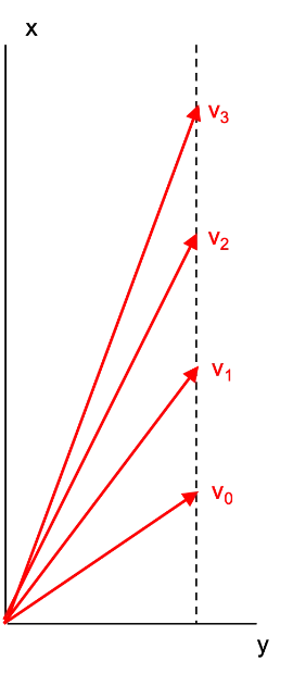

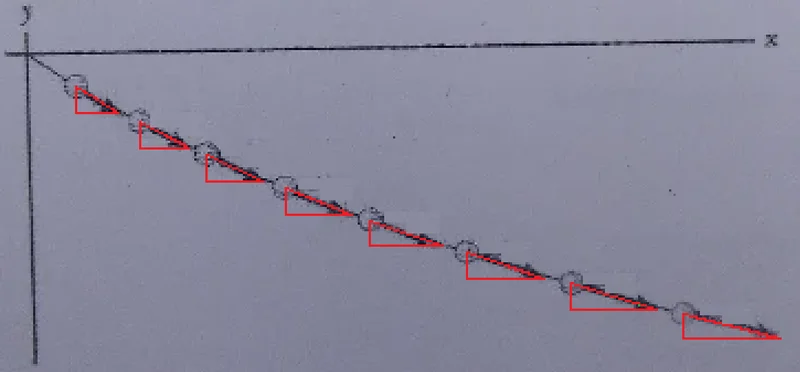

Hmm yes it seems to me that as the x velocity becomes large that one must imagine this as zooming out on the diagram in such case the y velocity vector would be become invisible but still must exist.
The vertical side of each triangle is the y-component of the velocity, which remains constant in time.
The horizontal side is the x-component of velocity, which increases with time.
The constant y-component of velocity represents the distance the object moves in the y-direction during one unit of time. So, even after a long time, the object will move the same distance in the y-direction per unit of time as it did at the beginning of the motion.

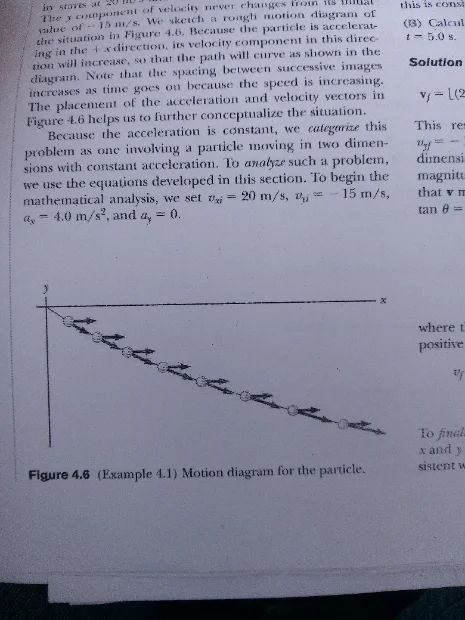

Is moving in x direction with acceleration, y direction no acceleration
Seems to me that there could be trouble here taking the limit as the x velocity becomes large such that the direction of motion in the y direction is neglected. The ratio of Y/X becomes so small as X becomes large that arctan Y//X could assumed to be 0 in some applications but here in this case of real physics it must exist else is big trouble could be

So just swap x and y. The point of this is that the velocity changes only in the one direction but stays constant and non-zero in the other direction. Look at the figure on the right. It shows the direction of the velocity vector in equal time intervals starting with v0 at t = 0.
