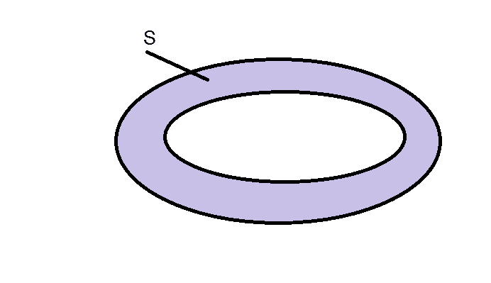

It is area of curve out - area of curve in

Yes, I understand what an annulus is. What I don't understand is the reference to its being constant. Constant with respect to what variable?
By the way, the integral looks quite easy to me.

So the inner circle is traced by the back wheel, and the outside circle is traced by the front wheel? And the area is constant with respect to the speed of the bicycle? As you go faster, the circles get bigger, and the difference between them gets smaller?
Or I could be misinterpreting your question altogether... :smile:

Are the tracks supposed to be circular, or can they be any shape as long as they do not cross?
If circular, does the constancy mean that it is independent of the inner radius, i.e., if the inner radius is made larger then the tracks will be closer together, and the annulus stays the same area?
If the tracks need not be circular, it is going to be very interesting proving the annulus area is independent of the shape.

It clearly does not depend on the mass of the bike or radius of its wheels either. Yet we are asked to show the area is constant with respect to something, presumably something which one might have thought would affect the area. What?!
Does the original question indicate whether the tracks are circular?

All that matters is the geometry of a bicycle, namely, that (approximately) the point of contact of the front wheel with the road lies in the plane of the rear wheel. Let the distance between the points of contact with the road is L. If you pick a point on the trace of the rear wheel (the inner trace) and construct the tangent forward from there it will intersect the outer trace a distance L from the point.
By the way, I suspect the result is true for arbitrary paths of the rear wheel. I considered two families of case: circle radius R and square side S. In each case, the annulus has the same area, regardless of size parameter.

You beat me to it. It's 5am here. I got up to write this post because I just figured out the geometric/calculus argument that proves the general case for the annulus area.
However, I still have no idea how this connects with the integral, have you? Can you solve the integral?
