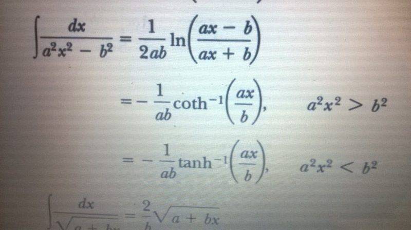

I had managed to find this form in a table of integrals, but
the form gives three different solutions (given in the
attachment). Now I proceeded by using the

Wolfram Alpha offers only a single solution for the left hand integral, which is
$$\left[\frac{\tanh^{-1}\frac{v}{a}}{a}\right]_{v_0}^{v_1}$$
This can be simplified using the fact that ##v_0=0##, and it's fairly easy to proceed from there.

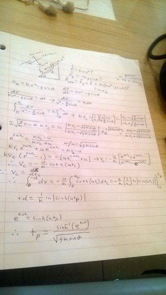

@andrewkirk I am not sure what you mean by "you have distance x pointing up the plane". I did say that only my notion of what a "positive distance" was is going up the incline. Can you elaborate?
@Student100 : I am attaching my work on the problem here...
I'm referring to this sentence you wrote in the OP:
"such that the positive x-axis is pointing up the plane"
Then later on you say
" This gives the acceleration down the plane as kv2−gsin(θ)"
However the formula you have given in the second case is for acceleration up the plane, not down, so it is only the words that are wrong, not the formula. Because you have taken the positive direction as up, whereas I have taken it as down, your formula differs from mine by a sign. That is, you will get:
$$\int_{v_0}^{v_1}\frac{dv}{a^2-v^2}=-k\int_0^t du$$
and that's what you have got, so up to there your work is correct. You just need to bear in mind that with your chosen direction the velocity ##v## will always be negative or zero.
Have you tried following the steps I outlined from that point on?

I was under the impression in my work that the resistive force would never be greater in magnitude than the effect of gravity. In my setup, $$k{v}^2$$ is the resistive acceleration and is pointing up the plane (in the positive x-direction) and $$g\sin(\theta)$$ points down the plane (in the negative x-direction). That would mean that $$k{v}^2-g\sin(\theta)$$ is the acceleration of the mass in general. My use of the phrase "down the plane" only carries the implicit assumption that block will never move up (i.e. that the resistive force will never exceed the effect of the weight on the block's motion). Is there something wrong in that reasoning? I am not trying to be dense, but I would really like to make sure I have the Physics right here before I put this problem to bed.
@andrewkirk : Figured it out. I kept looking at something wrong, but have seen the blood clot.
