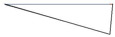

As far as I understand your formulas, you assume that the fraction of the band left/right of the mass is always determined by the position of the particle. This is certainly not true. A realistic (but massless) band will be somewhere between "same tension at both sides" (no friction) and "same proportion as at the first point of contact" (maximal friction).

The model is no-friction. You're right, this is a limitation but, with a small enough time increment, will it be material?
That issue has nothing to do with your timesteps.
Consider the following (extreme) example (black=rubber band):
Something like ~1/5 of the band is to the right of the particle - it is stretched, but only by a small factor relative to the rest position. In your calculations, you stretch the tiny red element by a large factor to get the right part of the band. This leads to very large forces from that side, and would require a lot of friction to prevent slipping of the rubber band.
