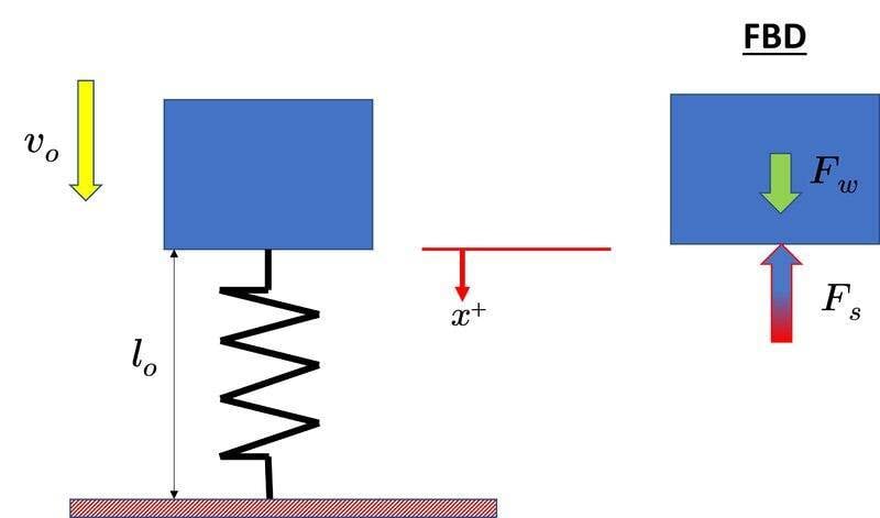

The classic problem of a block dropped on a vertical spring from a height ##h## above the scale: find the overall compression distance of a spring when a block is dropped on it and brought to rest. This problem is easy to solve using conservation of energy, potential gravitational energy and potential elastic energy. This is the energy approach.
What if we tried to solve the problem only using forces and body diagrams? I have been stuck thinking about it. How would we set the problem up? When the spring is fully compressed, the forces involved would be the weight of the block ##W## pointing down, the spring force ##F_s = k \Delta x## pointing up and the normal force ##F_N## pointing up.
We can first find the velocity of impact of the block with the spring: $$v_f = v_0 -2*9.8 (h) = -19.6 (h)$$ Then we can find the deceleration ##a_{net}## that the block experience going from ##v_f## to ##0##.
Third, we can set up the force equation $$F_{net} = m a_{net} =F_N + k \Delta x - mg$$
We know ##a_{net}##, ##g##, ##k##, ##m##, but we don't know the normal force ##F_N## so we cannot find ##\Delta x##...

fog37 said:
When the spring is fully compressed, the forces involved would be the weight of the block W pointing down, the spring force ##F_s=k\Delta x## pointing up and the normal force ##F_N## pointing up.
Seems to me you have one too many. Consider which force is working on which part of the system.
For an ideal spring that stays in place the forces working on each end are the same but opposite.

erobz said:
Also, care to elaborate on this?
And another thing you'll find is that even when considering the forces, the most efficient solution for how far the spring compresses will be "The Energy" argument in disguise. You will come to this by changing the independent variables in Newtons 2nd Law formulation from time ## t ## to compression ## x ## through the application of the Chain Rule.
You can go to ## x(t) ## directly, but it requires knowledge on the solution techniques to 2nd order non-homogeneous linear ODE's with constant coefficients.
Hi erobz,
Thank you. So the only forces acting on the block are the weight ##W## and the resistive spring force ##F_s##? I am conditioned to think that when a solid object box) touches another solid object (spring), a normal contact force ##F_N## must be included...But it sounds wrong in this scenario...
fog37 said:
Hi erobz,
Hello!
Yeah, its a conditioning problem. The normal force is there, its just that it appears in both the FBD of the mass, and the FBD of the spring. As you eluded to, we are typically only looking at this thing from one side when we consider the contacting body ( the ground for instance ) to be rigid and kind of "unresponsive" to loading as far as changing its own geometry goes.
I think in reality everything is actually a spring to some extent, and there are no truly rigid things, but we approximate when it really doesn't make that much of a difference. I think... Maybe not having that explained causes some conceptual confusion.
So please feel free to continue on, ( I'm assuming you have knowledge of Calculus ) because we aren't quite there yet as far as finding your ## x ## is concerned from Newtons Second Law.

erobz said:
Hello!

fog37 said:
Well, the ODE to solve seems to be $$m \frac {d^2 x} {dt}^2 = -mg + kx$$ with the additional conditions ## \frac {dx} {dt} =0## and maybe ##x(t_0)=0##...
I need to brush up on my calculus to solve this ODE...I can do it numerically I guess...
Just for consistency using the convention in the diagram ( yours is fine for your convention, but opposite the diagrams convention ).
You are correct.
$$ m \frac{d^2x}{dt^2} = -kx + mg \tag{1}$$
with initial conditions: ## x(0) = 0 ## and ## x'(0) = v_o ##
Lets not worry about brushing up on the 2nd Order ODE solution just yet. Insted let's start with the equivalent statement:
$$ m \frac{dv}{dt} = -kx + mg \tag{1'} $$
By applying the Chain Rule to the LHS we:
$$ \frac{dv}{dt} = \frac{dv}{dx} \frac{dx}{dt} = \frac{dv}{dx} v $$
Substitute that into (1'):
$$ m\frac{dv}{dx} v = -kx + mg \tag{2} $$
The equation has been transformed into a first order separable ODE.
$$ \int_{v_o}^{0} mv \, dv = \int_{0}^{x_{max}} \left( -kx + mg \right) \, dx \tag{3} $$
After integrating (and moving some terms around), (3) should look very familiar! Also, it satisfies your initial question without "beginning" with CoE.
If you feel you've been cheated we can do the 2nd order ODE too!
