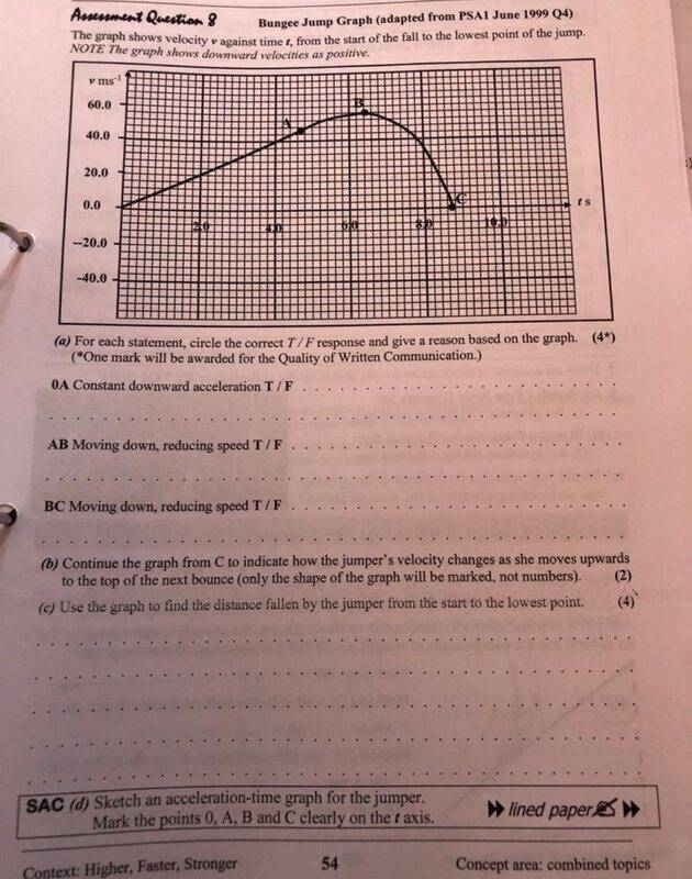

Motion problem -- Calculations given the v(t) graph of a person jumping

I need someone to check my working for this question please.

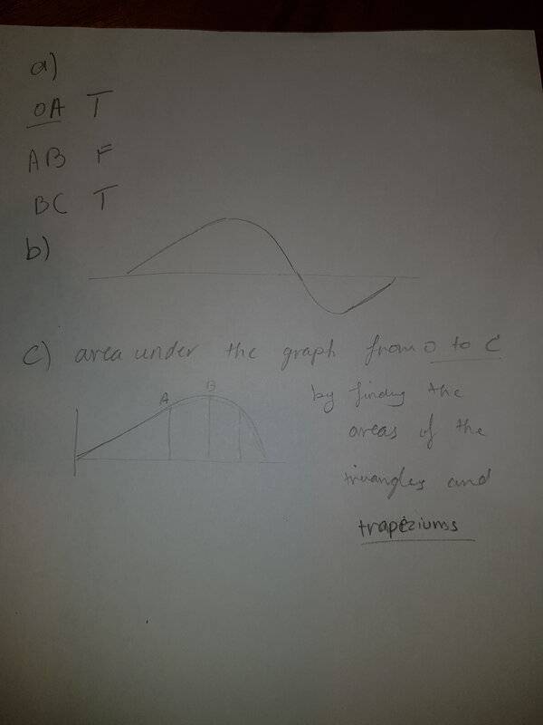

I have answered the question and have attached my working .
I'm not very sure about part b. I generally need someone to check my working and let me know if I've made a mistake.
Thanks

Looks good. Since it is on graph paper, they might want you to do some square counting, but unlikely.
Likes shk and Marso
Everything seems in order!
Likes shk
