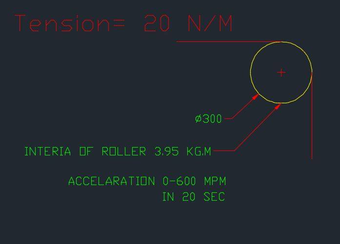

i need to select the motor for a roller of Diameter 300mm , length 1350mm
having inertia 3.95 KG.M ,Which needs to accelerate from 0 to 600MPM at 20 sec . Assuming existing web tension acting on the roller 20 N/M.

There are some problems with your units. For the tension, you give 20 N/m, but tension is a force and should simply be in N. For the MMOI, you give 3.95 kg-m, but the units should be kg-m^2.
Is it your intention to formulate this whole question on a a per unit length basis?
Also, what is the tension difference across the roller?

I am trying to find out the selection of motor .to rotate the roller .
Considering web tension, bearing drag , co efficient of traction and wrap angle .

Do you want the roller to provide the web tension, or do you want the web tension to drive the roller along with help from a motor? You show web tension on one side, but there is no indication of tension on the other side; what is your intention here?
The roller I have is OD diameter 300mm and ID 264 mm .
From the calculations I got moment of inertia is
27.906 kg.m^2 , which has to rotate at 190 mpm
Both Upstream and down stream web tension is 20 N .
