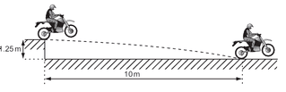

A motorcycle stunt-rider moving horizontally takes off from a point 1.25 m above the ground,
landing 10 m away as shown.
Diagram of a motorcycle stunt rider leaving a ramp horizontally, following a dashed parabolic path down to a lower landing; the take-off height is labelled 1.25 m and the horizontal distance to landing is labelled 10 m.
using tan [tex]\alpha[/tex] = [tex]\frac{Opp}{Adj}[/tex]
[tex]\alpha[/tex] = 7.1
then using v2=u2+2as
v2=0
let a = g = 10
s = 1.25(since we are calculating vertical)
u2 = 25
u = 5
but u is Xsin [tex]\alpha[/tex]
therefore x = [tex]\frac{5}{sin\alpha}[/tex]
x = 40 ms-1
no the answer is 20ms-1
what is wrong?

It is always a good idea to tell us what the question is. I take it that it is asking for the speed of the motorcycle when it takes off.
Your equation is not correct. The correct equation is:
[tex]h = v_0\sin{\alpha}t - \frac{1}{2}gt^2[/tex]
where h = change in vertical position = -1.25 m.
The angle of launch is 0 degrees. Work out the time of flight. From that you can work out its horizontal speed (it travels 10 m in that time).
AM
yea
i have found it
thx bro for stating the angle of launch
i always thinking that for no angle is given
we have to find the angle by ourselves using trigo ..
