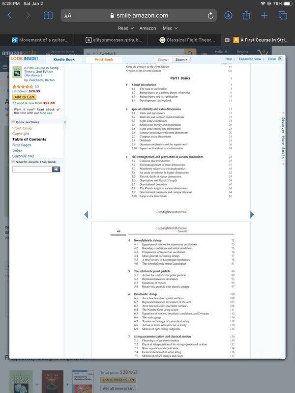

In case you have to go to string theory, it looks like ~50 pages in Zwiebach (chaps 4-6)
