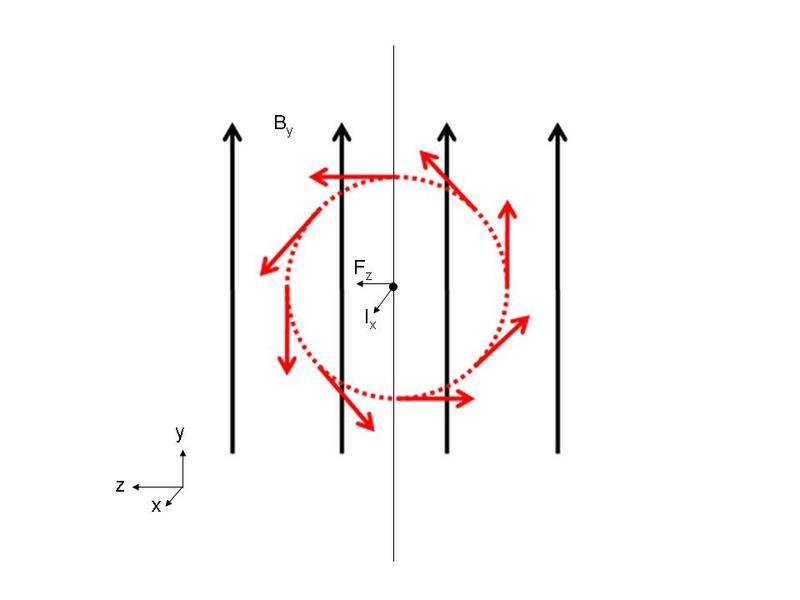

You can have it either way. The magnetic-magnetic interaction approach requires an integration over the magnetic field energy density of the combined vector fields. On one side, the vector fields add, and on the other side, they subtract, as rl.bhat pointed out. So using the Lorentz qv x B force method is much simpler. If you do a Lorentz transform into the charged particle rest frame, The static magnetic field transforms into an electric field, so all the magnetic fields disappear..

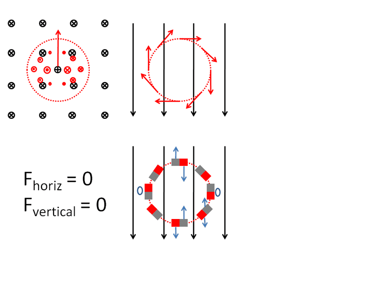

I have inserted an image:
At the top left: A proton moving through a homogenous magnetic field. The red, poorly illustrated, circles with dots and crosses, illustrates the cross section of the magnetic field created by the particle.
Top right: The same as in the top left image, but now our angle of view is 90degrees. The particle is moving into the screen.
Bottom image: To get an understanding of the top right image, let's illustrate the concentric magnetic field by 8 magnets. If we look at the forces excerted on the individual magnets, they only give a torque on the individual magnets. For the whole, they all add up.
So, how can there be a force directed left?
henxan said:
at: Bob S
Thanks! I sure hope it is possible to show a magnetic-magnetic interaction :).. but how??
In the attached thumbnail, a current Ix out of the page (in the x direction) crossed into the magnetic field By (in the y direction) produces a force Fz in the z direction) (see x y z coordinate system in thumbnail).
Calculate the magnetic energy density everywhere for a unit length conductor
[tex]W = \frac {1} {2\mu_0} \int B_{zw}^2 + (B_y+B_{yw})^2) dy dz[/tex]
where Byw and Bzw represent the field due to the wire. In particular, note that there is a higher energy density on the right hand side, where the two magnetic fields are parallel, than on the left side, where the two magnetic fields are antiparallel. Note that there is a gradient along z in (By + Byw)2 at z = 0.
[tex]F_z = \frac {dW} {dz} = \frac {1} {2\mu_0} \int \frac{d} {dz}(B_{zw}^2 + (B_y+B_{yw})^2)dy dz[/tex]
Bob S
