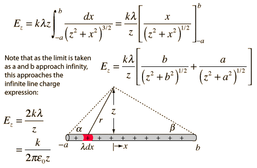

A point's field drops off as 1/r^2, an infinite line as 1/r, and a infinite plane as a constant. This goes for both electric and magnetic sources.
No, that is impossible. Please show me where do you draw your conclusions from. Can you please Google some link or show me Wikipedia article so I can see for myself what is it you are talking about?
  • #80
Coulomb's law only deals with a single point charge. You need to do the appropriate integrals for multiple charges. Though with line and planar sources you can use Gauss' law to derive the appropriate electric fields.
  • #81
For an infinite line, those equations are correct. You can do a google search for youself, and I suggest actually doing the calculus as an excersise to see where they come from.

So let's proceed to chapter two and apply Coulombs law to a line of charges. I've attached a derivation as a jpg file. So, now you have a reference and a clear derivation in terms of a law you can understand and a basic application of calculus. Contrary to two of your statements above. There is something to derive, and the final equation is not nonsense.
I'd like to state for the record that I don't appreciate someone who is unwilling to read past the first chapter of his book saying I'm "dreaming", "stating nonsense" and "from another planet".

Don't say I never did anything for you. Second link in google.
http://hyperphysics.phy-astr.gsu.edu/hbase/electric/elelin.html
[tex]\lambda= 1C/1m = ?[/tex]
[tex]E = \frac{\lambda}{2\pi\epsilon_0*r} => \frac{1C/1m}{2\pi\epsilon_0*1m} = \frac{1C}{2\pi\epsilon_0*1m^2} \ N/C[/tex]Coulomb's law: [tex]E = \frac{Q}{4\pi\epsilon_0*r^2} => \frac{1C}{4\pi\epsilon_0*1m^2} \ N/C[/tex]So, all that mathematics to change 1/4Pi to 1/2Pi? -- That is not right, it's some kind of butchering and symbolic derivation, while that integral was never supposed to be derived, but numerically integrated at the time of application, with given numerical input and REAL NUMBERS, not symbols. Symbols and derivation can not generalize arbitrary scenarios, and so that equation must stay in its integral form so it actually can be applied to wires of different and arbitrary lengths in relation to different and arbitrary geometry, where given input is defined by the REAL-WORLD numerical values.
[tex]E = \int_a^b \frac{Q*dl}{4\pi\epsilon_0*r^2} => \int_a^b \frac{1C*1m}{4\pi\epsilon_0*1m^2} \ Nm/C = 1 Volt = N/(m/C)[/tex]================== LET'S DO SOME REAL WORD PHYSICS, shall we? ==================
Attached Images File Type: jpg Efield.jpg
