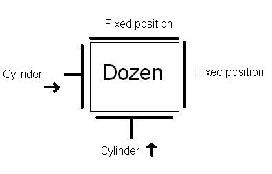

If you have some relatively small boxes next to each other you can pinch them with your fingers and lift them vertically. I would like to do this with big boxes, but I don’t know how to calculate certain things. I would like to make a frame with 4 plates on it which pressure the boxes horizontally so they can be picked up vertically. (Most likely I will also put a plate under the boxes to support but let’s pretend I will not). Picture:
Assume there are 25 boxes (5x5) and they weight 150kg total. How to calculate the pressure needed to be able to pick up all the boxes vertically with the horizontal pressure provided by the cylinders? Assume there is also no acceleration and the boxes only have to be pinched so they can be picked up and they won't fall.
Friction coefficient box on box μs = 0,5
0,5 Friction plate on box μs = 0,4
I know it’s impossible to exactly calculate it because of the many, many other factors. But all help would be appreciated.

OK. You will need to know the coefficient of friction and that would tell you the force needed to support their weight, without them sliding. Having worked out that force, you would need to decide whether the boxes would be strong enough to withstand this force.
The sideways force needed would be given by
Force = weight times coefficient of friction
You can see how, if these boxes were really slippery, you couldn't ever hold them up. So we need to know more.

If only taken the friction between boxes and their weight into account, would it have to be something like this?
Assumming that your picture is a plan view of your boxes, that the 25 boxes are lying on the ground with no stacking, that the boxes are totally rigid, and that the force Fn supplied by the cylinder is transmitted with no loss of force between boxes, then you could calculate it this way.

I wanted to use 2 cylinders to pinch the boxes like drawn in the picture in the first post, meaning I could divide the total force between two cylinders. Buw now that I think of it. If I press with 1500N on the boxes with cylinder 1 and cylinder 2 would start pressing with 1500N, it would bend/break the boxes so I should be using only 1 cylinder, right?

OH - is that picture a PLAN VIEW?
In that case it makes sense now. haha.
3000N makes sense and this is the force that either or both rams need.
As I said, the friction force is independent of area - counter intuitive, possibly, but don't think in terms of 'sharing the forces'.
What counts is the force on the outsides of the boxes. Total weight / μ will keep them all up there. Forget the inside boxes - you will have already included their weight in the Total.
Pros and cons for using one or two rams could be to do with the strengths of the cartons, which may be better off when pressed equally in both directions. You certainly would need a fairly tight fit so the boxes didn't spread too much sideways.
