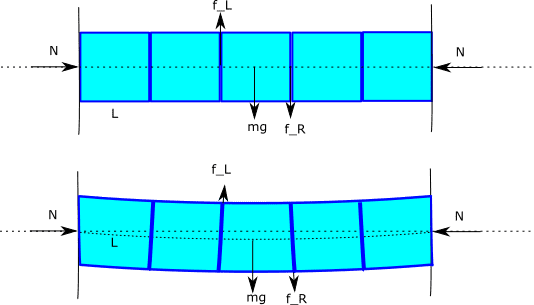

Two diagrams of a row of five cyan blocks pressed horizontally by forces N from both ends, with labels L, mg, f_L and f_R; the lower diagram shows the row bowed downward in the middle.
Schematic graphic not full scale
I have not come up with equations for the deformation block model, as they are much more difficult, and I don't think they will be a topic for this thread.
So that the blocks do not fall, they must have an original length greater than the ideal blocks, since when applying pressure each one must be compressed following Hooke's law, the final individual length will depend on the length of the arc.
It is known that the upper part of the faces exposed to friction shear are more compressed than the lower part, any small slip will change the coefficient of friction from stratum to dynamic, which if it is not large enough for the load, will cause collapse the stacked structure.

Start with five identical rectangular slabs in a horizontal row from left to right. They have height h, left-to-right width w and front-to-back depth d. Each has mass m. Gravity is given by g. We look at the row of slabs from the side.
Obviously we can ignore depth d. The bridge of slabs just has to have enough depth that it doesn't buckle in the horizontal direction.
At the left and right ends, the slabs are are pressed between pistons that exert a fixed force ##f_x## in the horizontal direction and maintain a fixed position in the vertical direction. The piston faces are vertical and are not free to rotate. The face of each piston is flat and mates with a flat surface of the end slabs.
All the faces are held together with pressure and friction alone.
If this way you define a new problem, I am also waiting for the solution, since you have not answered my question yet.
I believe that the idea of whoever opened the thread is to justify that the block will resist more weight, the exteriors or the interiors, I have already given my opinion, I hope yours, then we will see calculations.
The slabs do not deform at all. However, the pistons can move. For instance, if the center slab descends so that the row of slabs arches downward (as shown in your second drawing), the pistons will be forced apart slightly.
Simplify the situation to pretend that each slab has exactly three forces between it and each of its neighbors.
1. Horizontal pressure on its top corner.
2. Horizontal pressure on its bottom corner.
3. Sum of vertical friction on the face.

Write force balance equations and torque balance equations for each block.
You will find that if the system is stable at all (if the squeezing force is inadequate, it may not be), that it is statically indeterminate. In particular, the support force from the left hand piston and from the right hand piston need not be divided 50/50. So do yourself a favor: assume that the support forces from the end pistons are divided 50/50.
First step: Determine the pattern of forces that must exist if the structure is to be stable. Allow the coefficient of friction to be large enough that no slipping occurs.
Second step: Determine the minimum compressive force from the pistons needed for stability.
Third step: Determine the minimum coefficient of friction needed for stability under that much compressive force.
