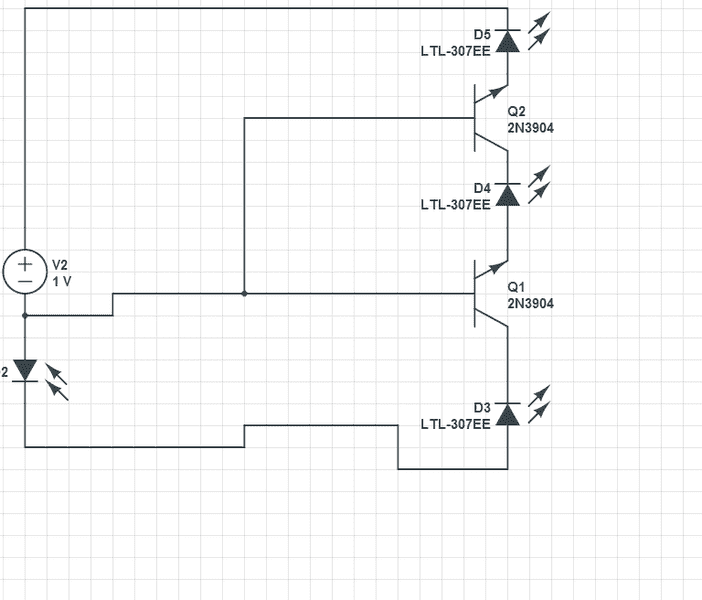

Hi,
so. I don't know a lot of electronics but this is effectively what I'm trying to create:
A photo diode controls the circuit, I assume they give out a current proportional to the intensity of the light it receives.
The ciruit, depending on the light intensity will light up different LED's. Also, there would need to be an ability to adjust this..I guess by having a rheostat connected to the photo diode.
Any help would be appreciated, I love to learn.
That is a very vague description of the circuit. Too vague to suggest anything specific.
Do you know how transistors work?
yeah I am a little aware. They're voltage controlled switches in this example?
Circuit schematic of a photodiode-controlled LED circuit: a 1 V source V2 drives a photodiode and three LTL-307EE LEDs D3, D4 and D5, switched by two 2N3904 NPN transistors Q1 and Q2.

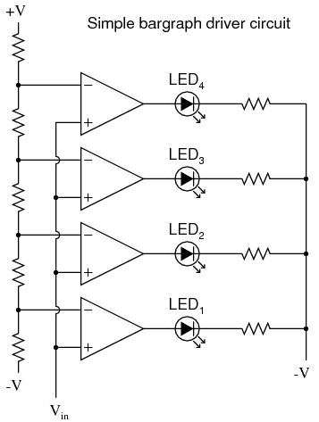

You could use op-amps. And to me it looks like you may have the battery polarity switched up in the example above just a heads up. This circuit shows how to use op amps to measure the level of a battery. You can easily modify it to measure the level of light. Connect your phototransistor in series with all of those resistors on the left side and for your V-in use the wiper of a potentiometer so you can calibrate your "meter", of course connect the two outer pins the same voltage as the phototransistor is and you input will be the middle "wiper" pin. For the op amps you could use the NE5532 (You can get them cheap here along with everything else you need http://www.taydaelectronics.com/ne5532-5532-ic-dual-low-noise-op-amp.html) and make sure all the resistors on the left side of the pic are the same value. And for the LED resistors you can use an online calculator for your LED's. As for your voltage source I would use a simple 9v battery but really anything 5-15vdc will work. Hope this helps let me know if you get it to work or have other questions

I don't see how this is supposed to work, even if you switch the battery polarity.
Start with specifications, please. What do you want to do? Do you want LEDs to light up if there is incoming light? Multiple LEDs at once, or more LEDs for more light? Do you want LEDs to go out if there is incoming light? Something else?
