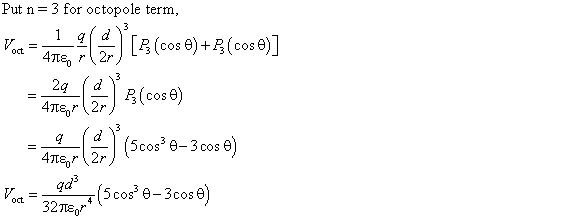

Can you tell me how they got from the second line to the third line here:
http:// https://www.physicsforums.com/attachments/230510-6-png.195282/?temp_hash=43fa2e3a321f0257bb4467f1b059eff3
Why is the Pcos(theta) = 1/2 5cos^3 - 3cos^2
Is it a half angle formula type deal or what?

Did you move to another problem? The octopole is not dominating your setup at large distances. The ##P_\ell## is a Legendre polynomial.

##P_n## or ##P_\ell##, it is completely irrelevant what you call the index. It is a Legendre polynomial all the same. The Legendre polynomials (or more generally, associated Legendre functions) evaluated at ##\cos\theta## contain the typical angular dependence of the multipole expansions (they form part of the spherical harmonics). ##\ell = 0## is the monopole with ##P_0(x) = 1##, ##\ell = 1## is the dipole with ##P_1(x) = x##, ##\ell = 2## is the quadrupole with ##P_2(x) = (3x^2 -1)/2## and so on and so forth.
