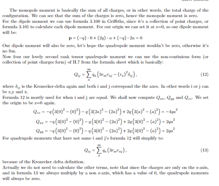

Calculate the mono-di and quadrupole moments of the three charges.
See solution.

This was quite simple, are my solutions correct?
Looks very good to me.

I love your explanations and motivations. Very thorough.
