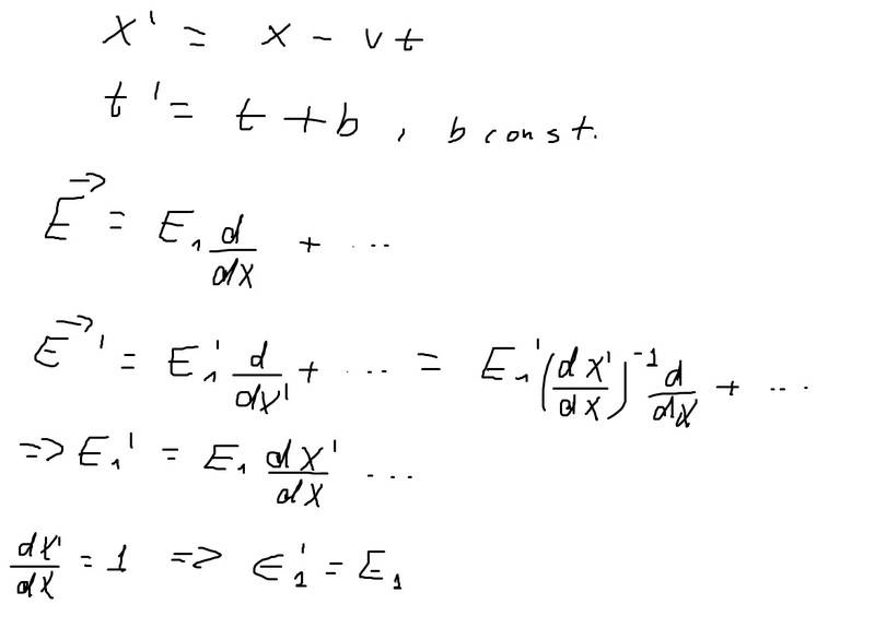

The usual Lorentz force you talked about is a 3-vector equation. We have ##\vec{F} = q (\vec{E} + \vec{v} \times \vec{B})##. Is your last statement quoted above equivalent to saying that under a Galilean transformation ##\vec{F}## does not transform such that ##\vec{F}{}' = \vec{F}##?
I'm going to show a simple calculation
View attachment 211363. The same should hold true for the vector ##\vec{v} \times \vec{B}##. Therefore the Lorentz force should be invariant under Galilean transforms. Am I doing something wrong? OBS: I've made use of ##d / dx##, etc because they transform as vectors. But I think I should have used ##e_x, e_y, e_z## instead.
Of course, if you do a non-relativistic calculation you cannot expect that it's giving the correct transformation laws. The most simple way is to use a covariant notation. For the mostion of a charged particle in an external electromagnetic field, given in terms of the Faraday tensor ##F_{\mu \nu}## the relativistic equations of motion read

@PeterDonis , it's not said there that the two times ##t'## and ##t## are equal. I think you looked at the question, not the answer, because it's the questioner who says ##t'=t##.
Dale said:
Yes, this approach is not showing what you want to show. What we are trying to show is how the whole equation transforms. So we want to show that when you transform ##F=q(E+v\times B)## you get ##F'=q'(E'+v'\times B')##. Under the Galilean transform ##v'=v+u## and ##F'=F## from the definition of the Galilean transform and the Galilean invariance of Newton's 2nd law. I don't remember the reasoning why ## q=q'## but I am sure you can dig that up somewhere.
So consider ##u=-v##, then ##q'E'=F'=F=q(E+v\times B) \ne q E##. Similarly for B.
I see. As ##q'=q## we have to conclude that ##E' \neq E##. But what about the link I posted just before your post? Maybe you want to look up the answer to the question that is posed there.

I can't say what you are doing with Galilei transformations, and it's way more complicated to consider non-relativistic electrodynamics than the full theory, because the literally natural realm of electromagnetism is relativistic physics. That's why historically relativity has been discovered by many people at the beginning of the 20th century (and finalized and fully understood by Einstein in 1905 and Minkowski in 1908) by thinking about electromagnetic phenomena.
So why is electric charge a scalar? Using the Maxwell equations alone (no need for closing the system by the mechanical equations for the matter thanks to gauge invariance), you get
I agree 100%. I am very likely making mistakes with the Galilei transformations since I see little value in spending a lot of effort learning how to do a wrong thing correctly.

@PeterDonis, I think your disconfort with the invariance of the Lorentz force, i.e. ##F' = F## can be resolved by noticing that for a particle ##q(E + v \times B) = d (m v) / dt##, i.e. the RHS is Newton's second law, which is invariant under Galilean transformations. So we must have invariance of the Lorentz force too. I think this is the reasoning of the author of that post.
