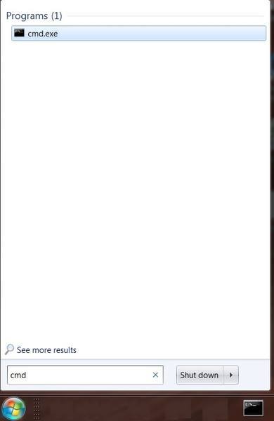

Thanks for the info. How do I ping www.cnn.com? I clicked it and it just open the CNN page.
The forum's web page is automatically creating a link.
Open the Start menu and type cmd in the search box. You should get something like cmd.exe. Open that and type the command:
ping cnn.com
