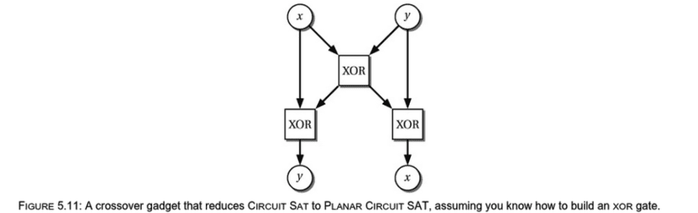

This is plain C rather than C++ ##-## it's an example of nifty memory conservation ##-## (I copied this example from a wikipedia article and added some comments):

For @yungman, who is a hardware guy: this is analogous to using 3 XOR (or 12 NAND (or XNOR (or with inverters AND or OR))) gates to keep a crossover planar.
from https://www.chegg.com/homework-help/questions-and-answers/complete-crossover-gadget-figure-511-hence-reduction-circuit-sat-planar-circuit-sat-design-q28238847:
The point that I'm trying to make here is that trying to not treat memory as if it were inexhaustibly freely available is something that programmers have conscientiously and inventively borne in mind, wherefore, I think that it might be good for you to try to follow some of the examples, and not try to read an entire file into local memory, only so that you can then display its contents ##-## I think that this point may be worth a few think-time moments for you.
