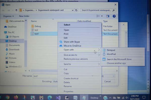

My issue with the debugger is I cannot display what's being written in the file while it is running. Obvious, the index = 5 meaning while loop in line 15 was run 5 times.(incremented to 5 on the last loop). Is there any way to display what is written into the file step by step.
I don't know what I did wrong in the program and I don't know how to make the debugger help me more where it went wrong.
Your code is attempting to display the bytes whose values are 1, 2, 3, 4, and 5 as characters. None of these is a printable character.
You can see what's in the file by opening it and viewing it with a binary file viewer.
In the Visual Studio File menu, select Open, and then File on the popup menu. Select the file you want to view.
In the Open File dialog, in the drop down menu for Open, select Open With...
In the Open With dialog, select Binary Editor.
That will show you exactly what's in the file.
This was discussed in your previous thread. The person who mentioned it said that this was something new he had just found out. Another person and I had never heard of it, but it's a very useful addition to VS.
The array you're trying to display, Ar, is an array of type char., so the << operator will display the values 1, 2, 3, 4, and 5 as type char. None of these represent printable characters. If you added 48 to each of the values in Ar, you would get the characters '1', '2', and so on.

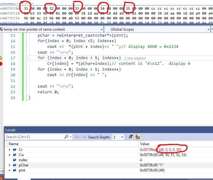

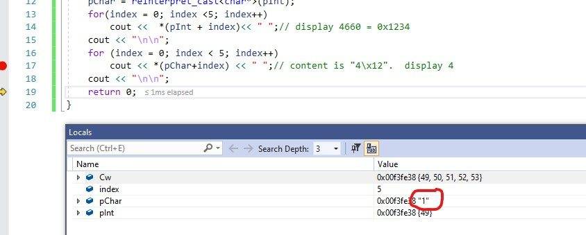

In post #57 of the closed thread, you gave an example. I put it in the program:
C++:
#include <iostream>
#include <fstream>
using namespace std;
int main()
    int x = 0x1234;
    int *pInt = &x;
    char* pChar;
    pChar = reinterpret_cast<char*>(pInt);
    count << " *pInt = " << *pInt << "\n\n";// display 4660 = 0x1234
    count << " *pChar = " << *pChar << "\n\n";// content is "4\x12".  display 4
    return 0;
In debug mode, it shows the *pCar = "4\x12" and display 4. You said the first byte of the four-byte representation of 0x1234 is 0x34. I don't follow. 0x1234 is only 2byte(16bits), how do you get 4 bytes? I thought MSByte = 0x12, LSByte =0x34. 0x12 is not displayable, so it's blank, only ASCII of 0x34 is 4, so the 4 is display.
Can you clarify?
thanks
When you write an integer to a binary file in this way, what is written depends on the internal representation of an integer as decided by the compiler which is usually based on the target CPU.
In this case this appears to be 32-bit little-endian i.e. LSB first (which is what you would expect targeting an Intel CPU in x86 mode) so the hex value 0x1234 is stored as 0x34 0x12 0x00 0x00. When you look the debugger it only shows you the first two bytes, representing 0x34 as the ASCII character "4" and 0x12 as "\x12". It does not show the third and fourth byte because pChar is a C-string and the null character 0x00 terminates a C-string. This is why it is a bad idea to use a C-string for a binary file.
Furthermore, if you compile the same code targeting say the 64 bit ARM processor on a Raspberry Pi 3 which uses big-endian format and use it to read the file it will (probably) read in 0x34 0x12 0x00 0x00 as the high 32 bits of a signed integer and read in whatever is in the next four bytes as the low 32 bits, corrupting everything. Generally it is a bad idea to create files which can only reliably be read by the processor that wrote them (although this is OK for temporary files).
Although (I think) it is not part of the C++ standard, most compilers implement an unsigned 8 bit integer type uint8_t which avoids the confusion caused by the duality of char as representing both an integer in the range 0-255 and an ASCII value, and the the fact that an array of char is interpreted as a C-string magically terminated by a null.
Conculsion: use std::filebuf and uint8_t for binary data.

I want to see whether there is anything I can do in the debugger that tell me what I only display {1 2} using pointer pChar.
C++:
//int char pointer pointing to same thing
#include <iostream>
#include <fstream>
int main()
    int index = 0;
    int Cw[] = { 0x31,0x32,0x33,0x34,0x35 };
    int *pInt = Cw;
    char* pChar;
    for(index = 0; index <5; index++)
        count <<  *(pInt + index)<< " ";// display 1 2 3 4 5 6
    count << "\n\n";
    for (index = 0; index < 5; index++)
        count << *(pChar+index) << " ";// display 1     2
    count << "\n\n";
    return 0;
I stepped through the program, you can see when I stepped through line 16 and 17, I can see the index incremented from 0 to 5, but the content the pointer pointed to only had "1" in it and never fill 2, 3, 4, 5.
In the final print out, it displayed {1 2} with space between them. Here is the picture after I stepped through to index = 5.
Anyway to see more detail using debugger?
Thanks
Not using the Locals or the Auto windows. If you have a pointer variable, all that will be shown in the single thing that's at the address the pointer hold. Since pChar is a char *, all that will be shown is a single character, even if the pointer is pointing to a C-type array of characters. If the pointer is of type int*, all you'll see is a single int, again, even if the address is of an array .
However, you can open a Memory window, and look at the memory starting from the address the pointer holds.
In the Debug menu, select Windows --> Memory, and then select Memory1, or any of the other three memory windows. Of course, you need to do this when the debugger is running. You won't see as many options if you aren't debugging.

I really need help with this program. I added Cr to read it back and I can see step by step at line 16 that it wrote the wrong thing into Cr[]. It wrote {49, 0, 0, 0, 50} into Cr. I show the memory where pChar pointing, you clearly see 0x31, 0x32, 0x33, 0x34 and 0x35 to be copied to Cr.
C++:
#include <iostream>
#include <fstream>
int main()
    int index = 0;
    int Cr[5];
    int *pInt = Cw;
    char* pChar;
        count <<  *(pInt + index)<< " ";// display 4660 = 0x1234
    count << "\n\n";
        Cr[index] = *(pChar+index);// content is "4\x12".  display 4
        count << Cr[index] << " ";
    count << "\n\n";
    return 0;
I am loving the debugger! Just I think at this point it's beyond debugger. The debugger show everything already and I still don't know what I did wrong. It's very simple
Cr[index] = *(pChar + index); this is the same way I read Cw and it print out correct. Please take a look. I literally see the program wrote the three '0' one by one as I stepped through the program. You can see the value of pInt and pChar has the same value 0x007cfc00.

pbuk said:
You don't get 5 characters you can see displaying, but remember that a char can have many values that do not show up when displayed as a char. Do you remember how to show the actual value of a char?
You have named your variables well this time, so here's another hint as to what is going on: pChar and pInt point to the same memory location, but is this true for pChar + 1 and pInt + 1? How can you check?
I tried to count << (pInt + index), it works I see the address incremented by 4 every time.
BUT I cannot count << (pChar + index).
Are you telling me you cannot use (pChar + index) for the next location? I definitely have not learn about this.
Thanks
Yes: C++ overloads the + operator so that it adds sizeof(*pInt) every time, and pInt is currently being compiled as a pointer to a 32 bit (4 byte) integer.
No, this certainly should work - probably some finger trouble or missing a ; or something. Never mind, predict what it should be doing by modifying the explanation above: "C++ overloads the + operator so that it adds sizeof(*pChar) every time, and pChar is a pointer to a [...] bit ([...] byte) character."
You are nearly there; there are 3 clues to the mystery you need to put together to solve it:
  1. fill in the gaps in the sentence in the last post
  2. note that 0x31 = 3116 = 4910 and 0x32 = 3216 = 5010
  3. remember that x86 integer format is 32 bit little endian so the hex value 0x31 is stored as [... ... ... ...] and 0x32 is stored as [... ... ... ...]
