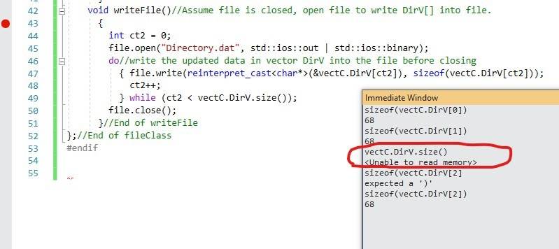

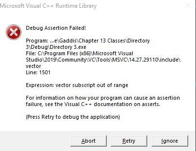

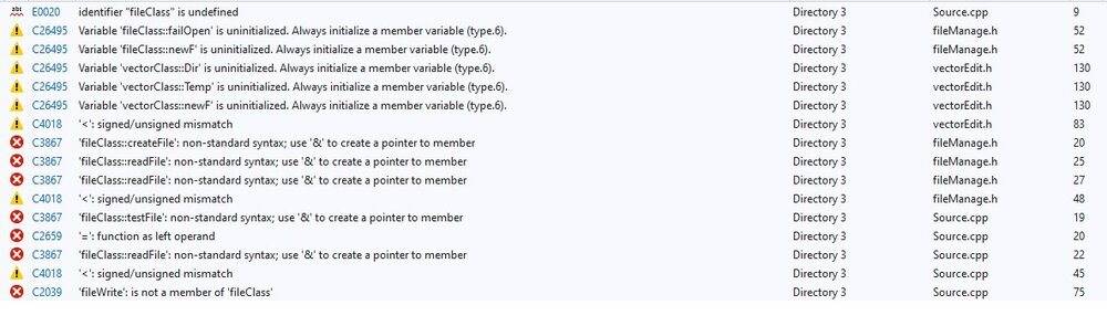

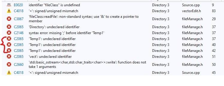

Hi
I am integrating my program into using different Classes. I have been trouble shooting for a while and I am stuck on this error and I don't understand the problem even reading online. I am using two Specification files with no Implementation files. I just want to make it easier with less files. I have one header file for working with read and write file. Another header file to work with add, sort, delete and display content of the vector DirV[].
This is fileManage.h for read and write to file.

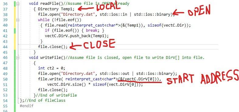

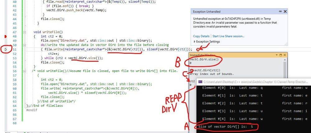

    void readFile()//Assume file is OPEN already
      {while (!file.eof())
         { file.read(reinterpret_cast<char*>(&(vectC.Dir)), sizeof(vectC.Dir));
           if (file.eof()) { break; }
           vectC.DirV.push_back(vectC.Dir);
    void writeFile()//Assume file is closed, open file to write DirV[] into file.
        int ct2 = 0;
        file.open("Directory.dat", std::ios::out | std::ios::binary);
        do//write the updated data in vector DirV into the file before closing
          { file.write(reinterpret_cast<char*>(&vectC.DirV[ct2]), sizeof(vectC.DirV[ct2]));
            ct2++;
          } while (ct2 < vectC.DirV.size());
        file.close();
      }//End of writeFile
};//End of fileClass
#endif

What is error C3867? I read on line and I don't understand. I don't know what I did wrong.
Please help. Also please comment on how I write the program. First time doing this, no idea whether this is right or not. I know I have to split up the vectorEdit.h as it's very long.
Thanks

On the file class line 20, createFile; should be createFile();

You'de be better off to not take the advice in that article; it is not very good. But your errors are not exactly to do with it anyways.
You know if a member function is static if you defined it as static.
All functions are called with parenthesis, static or not.
I think that VS mistakenly thought you just wanted to state the address of the function. It's just a sort of bad error message.

Please help in another issue. The program is now running. The way the program works is I don't write into to file until the program is about to quit. You can see I call writeFile() right before the program quit. Before that, everything is working, I can add names, it will sort to the right order, I can delete, view. Everything is working. This means the main() is working with vectorEdit.h perfectly. But then when the program goes to writeFile() and attempt to read from vector DirV[], it generate this:

So I went to debug and put a break point at line 43 of fileManage.h right before it starts copying. Then I use the Immediate window to look at the sizeof(vectC.DirV[0]) it gave me 68, I tried DirV[1] and DirV[2], they are the same 68. BUT then when I try to read vectC.DirV.size, it said it cannot read memory. as shown below:
I think this is why the program flag the "vector subscript out of range".
Please help me on this. I updated the files in post#1. It should compile and run up to the point of writeFile().

Thanks so much for the advice, I changed the readFile(). Originally I open the file in the calling function, I even specified file is open when calling readFile() on the comment line. BUT, I like your way better, cleaner. So I change my calling function to close the file before calling readFile(). Then in readFile(), I open, read and close all LOCALLY. This is GOOD advice and I'll take it to heart. Below is the modified readFile(), but I still get error for Temp1 being undeclared.
On the writeFile(), I still don't get it. I read your explanation. I tried to compile as what you have, it won't compile, so I change according to your description. The starting address of the vector should be &(vectC.DirV[0]), and total length of the vector is (number of elements) X (size of element). So I change it to vectC.DirV.size() * sizeof(vect.DirV[0]). But it still won't compile.
This is the error list:
It complain Directory is undeclared, thereby Temp1 is undeclared.
Thanks for your time, this is really above my head at this point. I took a very large bite this time! maybe larger than I can swallow!
EDIT
I change local variable Temp1 to Temp that is declared in vectorEdit.h, I use Temp dedicated for readFile() and not use it anywhere else, that eliminate the error on Directory and Temp1.
Ahh, because Directory is nested inside vectorClass. So it needs to be vectorClass::Directory. Or just move Directory outside of vectorClass.
.data() is fine, it will be exactly the same result as getting the address of the first element.
http://www.cplusplus.com/reference/vector/vector/data/
You put sizeof(vect.DirV[0]) instead of vectC.

The thread took a detour after post#7. Now I am back to the original issue. This is what I got in debug showing in the Immediate Window. Something is wrong as shown:
1) I added one line in main() to count the vectC.DirV.size() and is shown in A that shows there is 5 elements. Also you can see in the cmd window I read out 5 elements labeled. Theses are READ from vectC.DirV[].
2) in the Immediate Window after I stepped the writeFile to the out of bound error, vectC.DirV.size() = 0. There is nothing done to DirV[] between A to B.
I think the problem is in writeFile(), since vectC.DirV.size()=0, anything is out of bound.
Can anyone help? I have no idea why vectC.DirV.size() change from 5 in main() to 0 in vectorEdit.h.
Thanks
I'm just glancing now. Is the vecC in main the same one in your file object
In main shouldn't you use file.vecC ?

I edit this post. I declared std::vector<Directory>DirV; in line 17 of vectorEdit.h, this should make DirV[] global. I should be able to use vectC.DirV in main() and fileManage.h.
