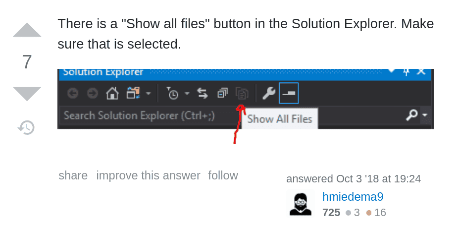

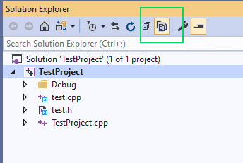

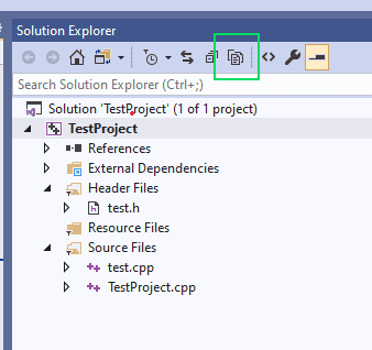

I really doubt any damage is done to the projects. It sounds like maybe you just accidentally changed some settings in VS? Usually when someone changes global settings, they intend the changes to persist. It's like if you change the color settings on your TV, it will affect every movie you watch. But you haven't damaged your DVDs. You just need to figure out how to reset those settings to what they were before.
Have you tried resetting the settings?
https://stackoverflow.com/questions/26863/how-do-i-really-reset-the-visual-studio-window-layout
Maybe you toggled "show all files"?
https://stackoverflow.com/questions/52633866/project-files-hidden-in-visual-studio

You really did it! Thank you! Thanks a Billion!
I have to watch it again to take down notes. I opened a new project, They are there! I looked at another old file, it's there.
I can't thank you enough. You just save VS for me. You are the expert in VS!

Yeah, actually I notice in your post #16, in one of the images you have the "show all files" button and some other button pressed (yellow highlighted buttons) and the others you don't. I guess that was the problem?
I am just good at googling I guess? It's a skill you pick up as a programmer. You will run into problems all the time, and you have to know how to figure out the solutions by looking things up.

Remember the nose?! I watched that 1 minute video so many times as it's blur, also the tittle just blocked the top manual. Had to watch it over and over and guess. This is the steps:
-Tools-->Import and Export setting-->Reset all setting-->No, just reset setting, overwriting my current setting-->General-->click Finish.
I swear I saw the page Import and Export setting-->Reset all setting before. It just didn't click in my head as I never relate this to import and export setting. When I saw that part, I started to know where to look for that and found it.
You really make my day. I cannot live with one mistake and change everything in all projects. I don't blame the mouse, $hit happens, it's how you recover from it that matters. Now this is 1/2 minutes job, I can live with it.

I don't think it was deleting things alone that caused your problem. I think you toggled the "show all files" button that I put a green box around. You can see in your post 16, you had it unpressed, then had it pressed (compare the two images). Try pressing it ON/OFF and see what happens.
Here it is unpressed.
Here it is pressed.
Of course deleting things you're not supposed to, or in ways you're not supposed to might have messed things up as well, if that's what you did. But deleting something in one project alone would not have changed your other projects (unless it was a file that both projects are using).
Here it is pressed.
I just went back and toggle that button. Now I see Header Files and Source Files either way. It was not like this before. I think I deleted the files. I cannot say for sure whether I press that before, but it started out deleting the .h file when I was experimenting with Add-->Existing vs Add-->New. That's when I deleted the .h and create new one back and fore.
