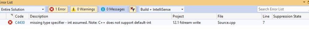

I encountered a strange error. I have 2 EXACTLY same code in this program, I just use /* */ to disable one or the other. The bottom one works, the top one giving me error. I literally copied the content inside main() from the bottom to the top, still, the top one fails and bottom works.
C++:
#include <iostream>
#include <fstream>
#include <iomanip>
using namespace std;
main()
    fstream    dataFile;
    dataFile.open("C:\\Users\\alanr\\Desktop\\C++ exercise\
\\Gaddis\\inout files\\demofile.txt", ios::out | ios::app);
    dataFile << " Lucky " << " Chicky\n\n" << " Slave " << " Rooster\n\n";
    dataFile.close();
    return 0;
/*#include <iostream>
#include <fstream>
#include <iomanip>
int main()
    fstream    dataFile;
\\Gaddis\\inout files\\demofile.txt", ios::out|ios::app);
    dataFile.close();
    return 0;
If I missed anything, I must be really blind. Like I said, I copied the content inside main() from bottom to the top, still have problem.
The error is :
And when I choose run anyway, the error is:
I did closed the VS and start over, also, I clean Build solution every time also. Also, I printed the code out and compared word by word. Can you see why?
thanks

They are not exactly the same... :wink:

The content is the same. I copied the lines inside main() from the bottom to the top except return0;
You can see line 8 to line 12 is the copy from the bottom line 23 to 27.

main()
int main()
I don't know if that's the source of the error, but it appears that it was not a true copy/paste...

My god, I only look at the inside content! Thank you. I wasted an afternoon, comparing word by word inside main!
Funny, I did that quite a few times, the compiler always flag me if I forgot "int" before main. It didn't this time. I went back and look at the program, it does not have red wiggle line under that. I know because it happened many times before and it will show the error so I know to put it in.

Look at the error the compiler gave you -- it says the problem is on line 7. You can also double click on the error code, C4430, which will take you to a doc page for that error. No guarantee that it will be all that helpful. Several of the examples you've posted had compile-time errors. You could have saved yourself a lot of time by looking at the information that is shown in the error window.

It is indeed the source of the error.
